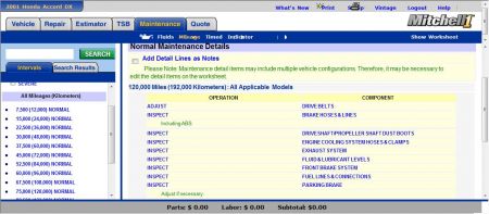

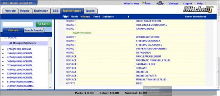

I would like to know what needs to be done at 120,000 miles?
Thursday, January 22nd, 2009 AT 11:30 PM
MECHANIC
75,992 POSTS
Maintenance at 120K normal service
