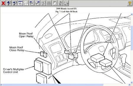

I opened the sunroof, but now it will not close. If you press the open button you hear a click, but when you oress the close button it does not close and you do not hear a click. The fuses are good. Could it be a relay? Where are the relays located?

Hi rwlc5,
If there is no click, it is notlikely to be the relays, More likely to be the switch or fuses.
Anyway I have attached the location so you can test them.
https://www.2carpros.com/forum/automotive_pictures/192750_MoonRoofRelay00Accord_1.jpg
