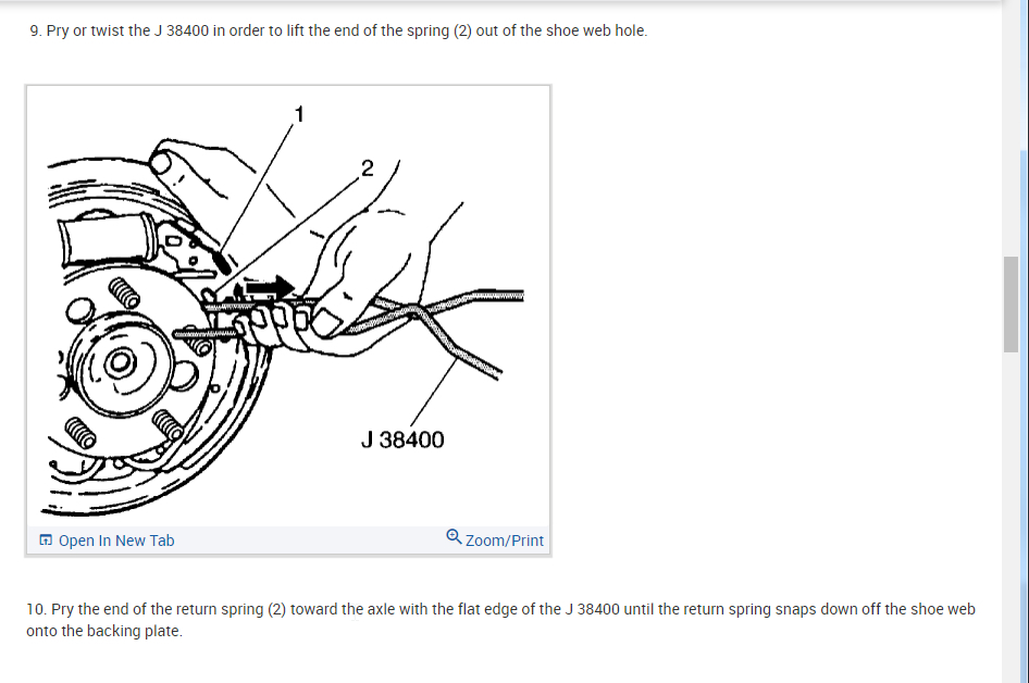

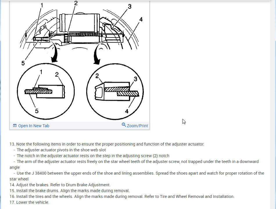

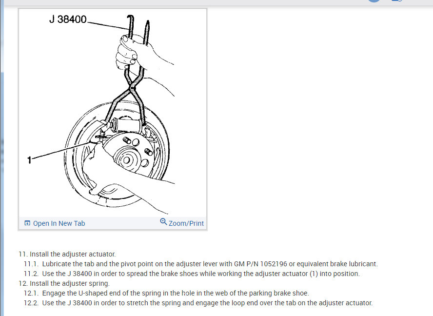

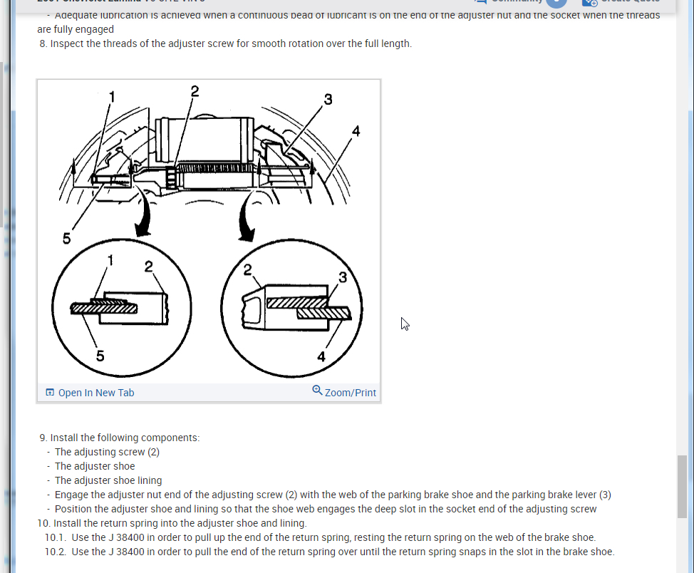

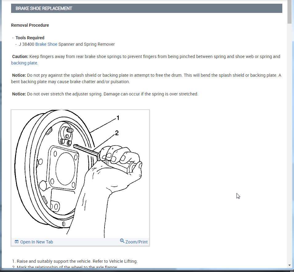

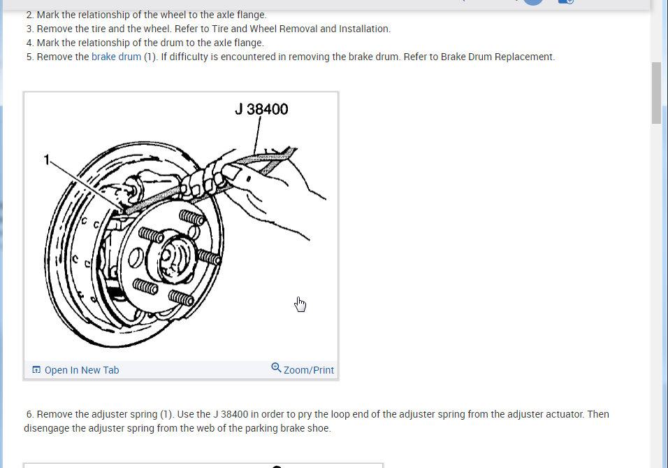

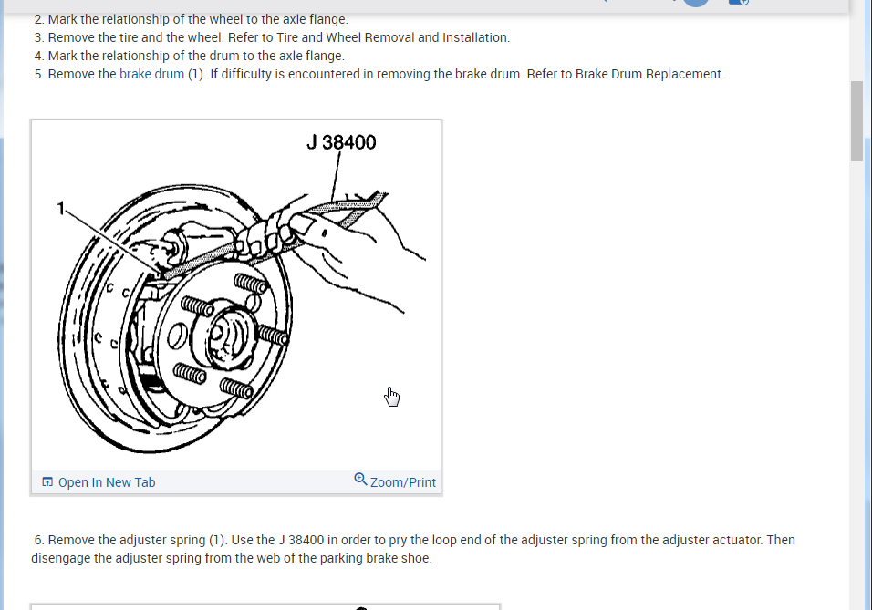

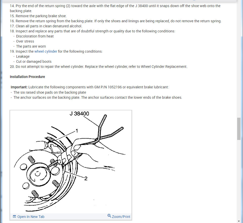

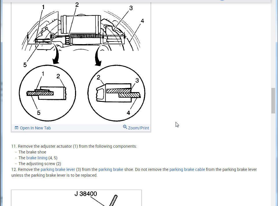

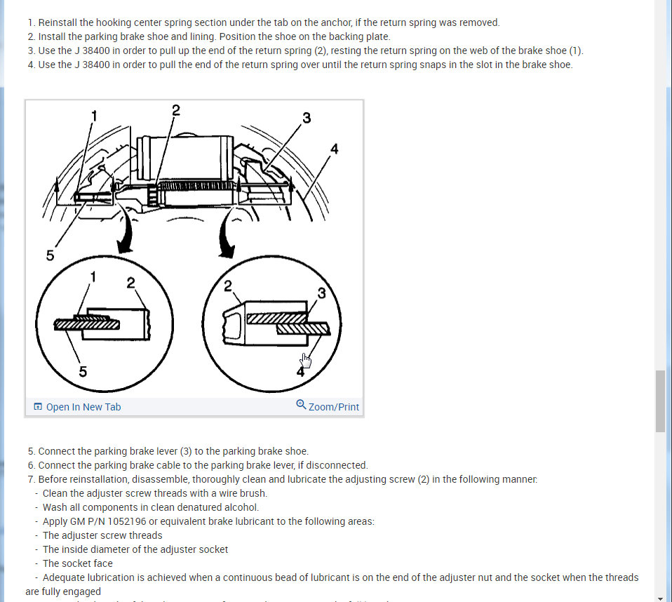

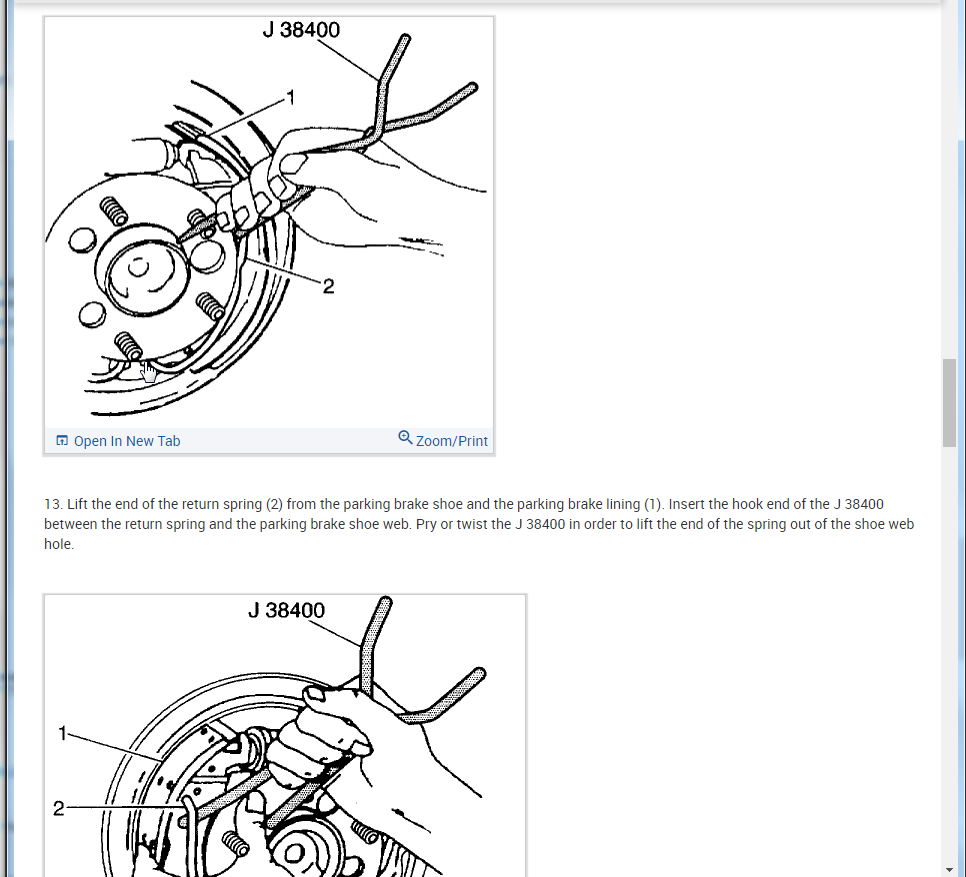

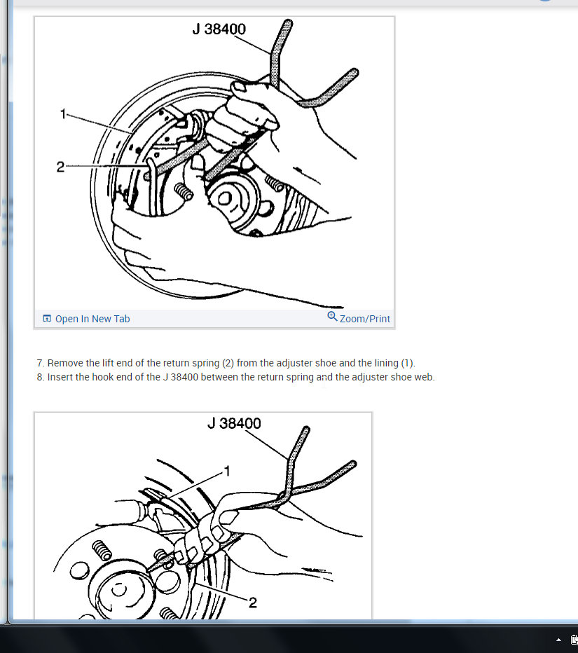

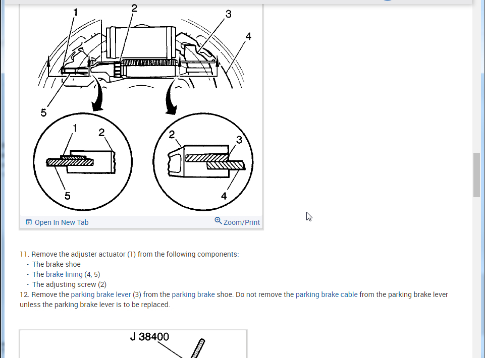

Im a first year apprentice mechanic and I was wondering if any one could give me a few tips on how I could do my bakes?
Monday, December 14th, 2009 AT 3:56 AM
MECHANIC
18,907 POSTS
Here is a guide that will get you started:
https://www.2carpros.com/articles/how-to-replace-rear-brake-shoes-and-drums
Below is the process from a like vehicle as we don't have a manual on this specific vehicle as it is not offered here in the USA. Please review this material and let us know if you have questions.
