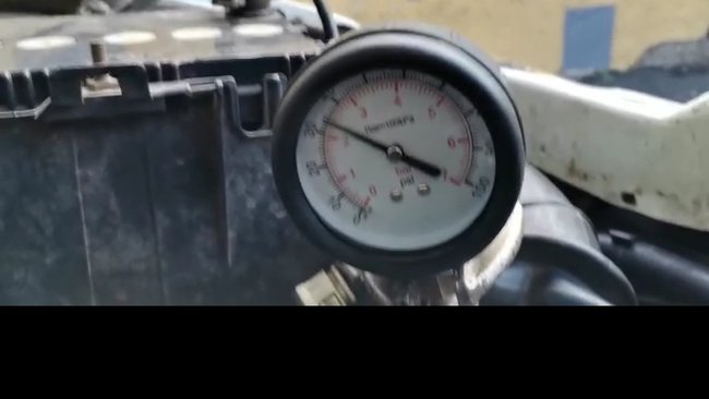

Hi, I bought the vehicle listed above with a stripped engine. Reassembled the engine with new rings, bearings, mains, thrust washers. New timing chain, oil pump and water pump also. The head went to the engineers who determined that there was nothing wrong with it, new valve stem seals fitted and skimmed lightly.
After assembly fitted engine into van, van starts on the turn. Idles at about 1,300 RPMs and the exhaust manifold glows orange.

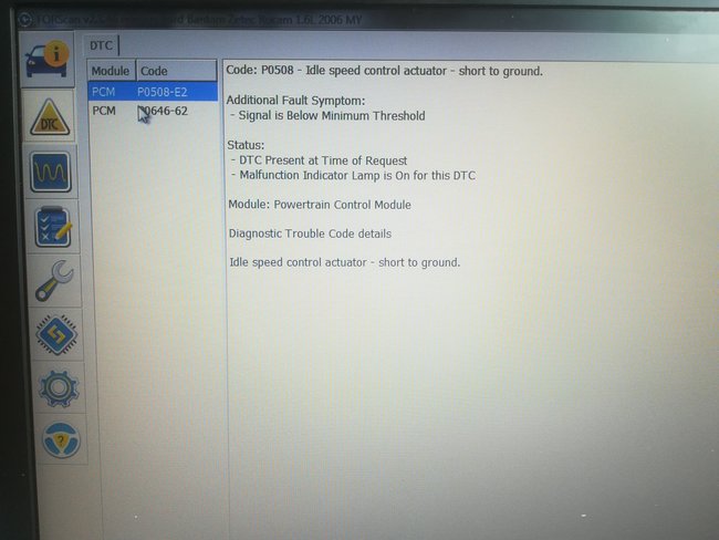

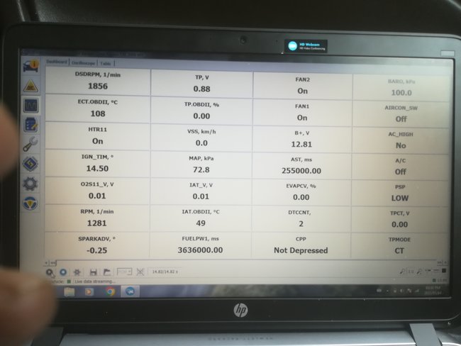

Cleaned injectors using carb cleaner, scanned the vehicle using Forscan and produced the code P0508 - Idle Speed Actuator short to ground. Replaced the idle control valve and started the van, still idling at 1,300 RPMs and exhaust manifold turns orange / red.

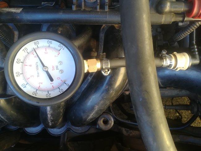

I did a fuel pressure test and at idle the fuel pressure is approximately 2.3 bar. The Bantam specification says that the fuel pump is three bars, unsure if the 0.7 bar would cause the exhaust to turn red / orange and also cause the idle to remain consistent at 1,300 RPMs.

A glowing exhaust manifold is usually caused by lean mixture, slow ignition timing or a possible blocked exhaust/catalytic converter.
A high idle could be caused by an unmetered air/vacuum leak.
As you already have determined low fuel pressure, I would suggest that you rectify this next. It could just be a blocked fuel filter or a possible faulty fuel pump. Check if this then cures the issue.
Once this has been rectified, try to disconnect the exhaust nearest to the exhaust manifold and let the vehicle idle. See if this cures the glowing manifold.
