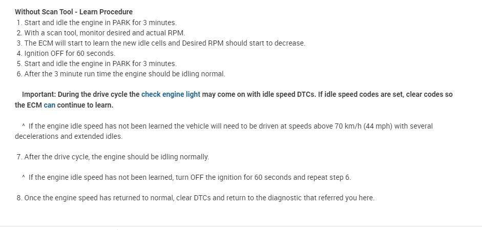

So my truck some how gives me a engine power reduced message and i can only go 30 miles an hour. so i read it could be throttle body. so i have a 2006 Trailblazer SS that has a matching throttle body and the symptom is still there. sometimes the error message comes on some days it doesn't. now the Idle speed is high. I will be driving and take my foot of the pedal truck doesn't decelerate. what issues am i dealing with? please help!

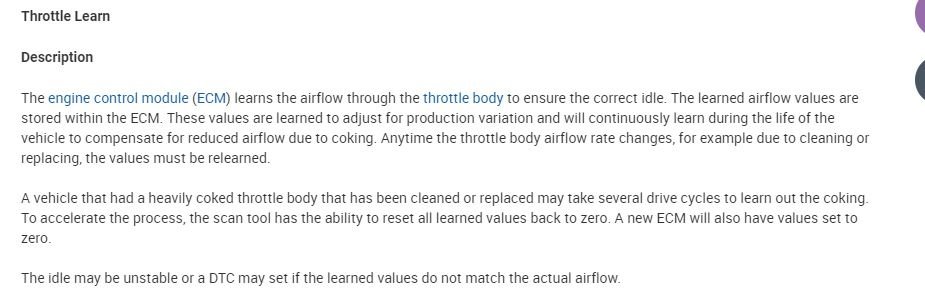

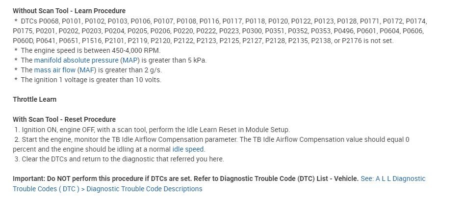

I would start by doing a relearn for the idle.

As carbon builds up in the throttle body of a high mileage vehicle, the ECM/PCM learns to compensate by increasing the throttle plate angle.
If enough carbon builds up, an idle surge, deceleration surge, tip-in hesitation, reduced engine power mode, and/or DTCs P0068, P0121, P1516, P2101, P2119, and/or P2176 may be experienced on high mileage vehicles.
If the throttle body is cleaned without performing an "idle learn reset/reset idle learn" with the Tech 2, the ECM/PCM may continue to compensate for previous carbon build up, causing it to return with a similar concern as well as DTCs P0121, P0506, and/or P0507.
In a similar fashion, if the ECM/PCM of a high mileage vehicle is replaced and/or reprogrammed without performing the Throttle/Idle Learn outlined in SI, the ECM/PCM may no longer compensate for existing carbon build up in the throttle body, causing it to return with a similar concern as well as DTCs P0121, P0506, and/or P0507.

If SI diagnosis does not isolate the cause of this concern, inspect the throttle body bore and plate for obvious carbon build up.
If carbon is present, follow the Throttle Body Cleaning Procedure in SI to clean the throttle body.
After ensuring that the throttle body bore and plate are clean, perform an "idle learn reset/reset idle learn" with the Tech 2 and re-evaluate the concern.
Notice: Depending on the vehicle you are working on, the "idle learn reset/reset idle learn" is normally found on the Tech 2 ECM menu for Module Set Up or Special Functions/TAC System.
