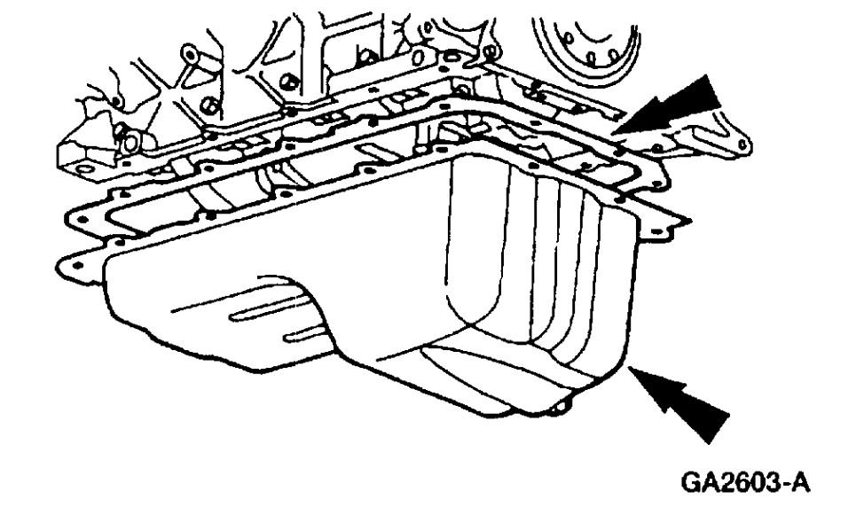

Oil is not going to the lashers, roller adjusters.

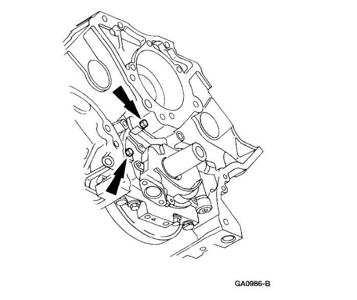

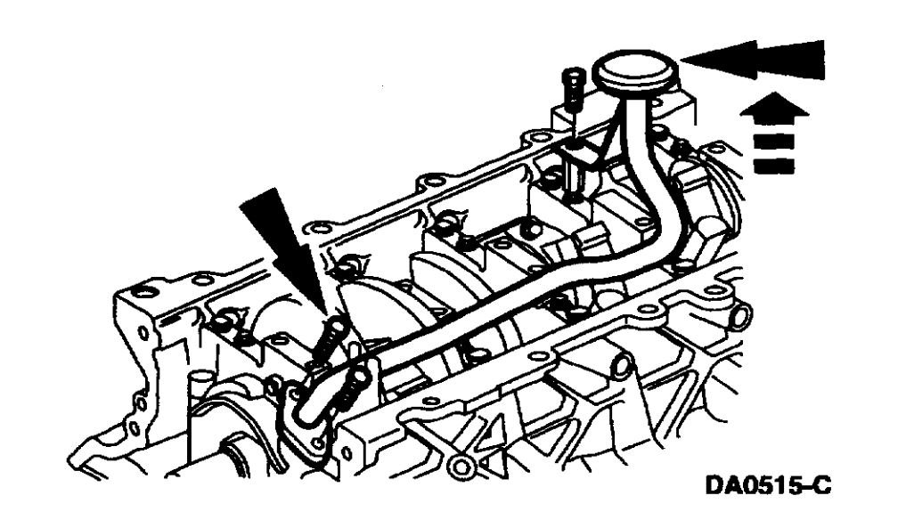

Good afternoon,
This could be a failed oil pump.
I would have a manual oil pressure test done to confirm.
I attached a YouTube video for you of the procedure. It is a major job for someone who has never done it before.
https://www.youtube.com/watch?v=kTn6LDWg2hI
