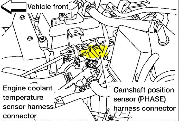

Had code, Had to change my ignition coil do I did and spark plugs as well? Turned car on and drove a half a block engine light came back on and the new code p0011. Please help

Anytime there is a problem with a coil resulting in a misfire, I replace the plugs. However, in this case the code you have isn't related to the coil or a plug. The code indicates there is an issue with intake valve timing (IVT). Did you do anything to a cam sensor? Is anything disconnected? Is the vehicle running properly?
I attached a pic of the sensor I'm referring to. Check it to make sure it isn't disconnected or damaged. Also, make sure the coolant temperature sensor is connected.
