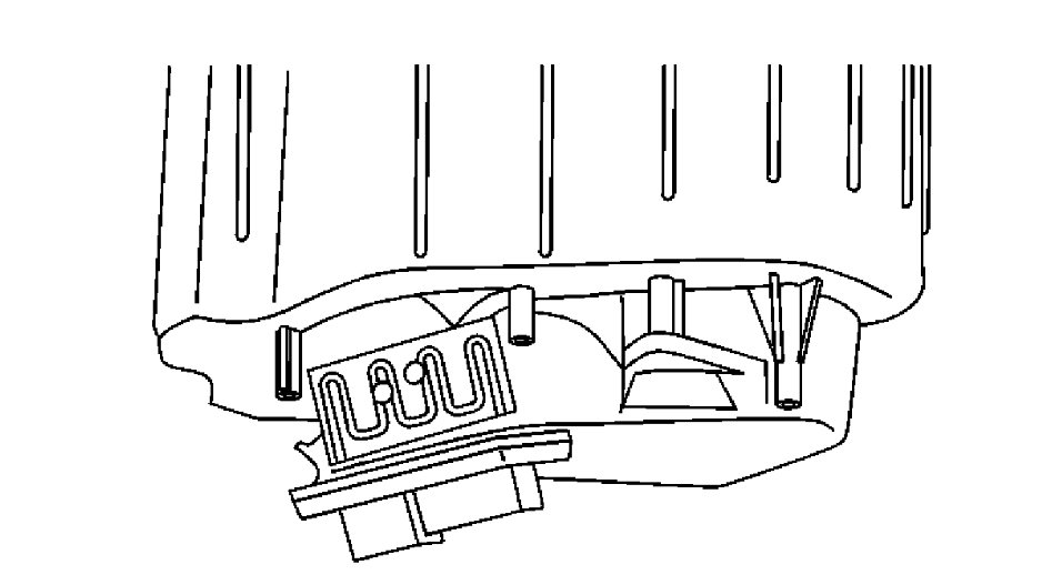

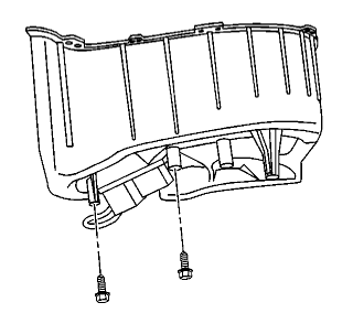

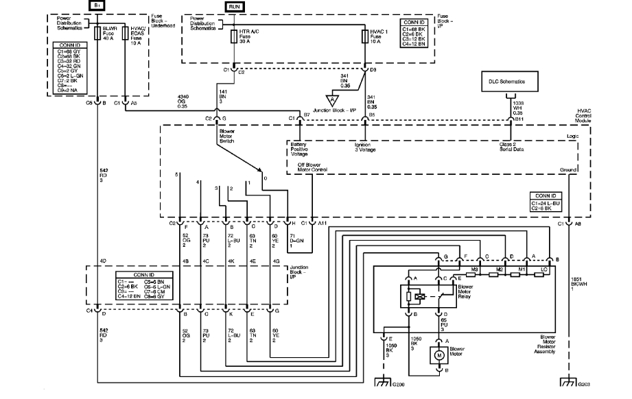

Heater fan will not shut off when engine is turned off. I have to remove fuse to turn fan off.
Tuesday, December 11th, 2018 AT 5:55 AM
13 Replies
Good morning,
There is a blower motor resistor that controls fan speed. When it shorts to power, this is the result.
It is next to the blower motor under the right side of the dash. I attached a picture and wire diagram for you to view.

Replace the blower motor resistor and connector, this is a very common problem. Post back with any other questions.
+1
Saturday, December 26th, 2020 AT 10:00 AM (Merged)
SHINY
  • 5 POSTS
Greatly appreciate the response. Hope this isn't too dumb of a question but I'm sligtly electrically impaired?)
Where do I find these little creatures? I'm not even sure where to look for the blower.
Thanks again
BRIAN 1
  • 1,030 POSTS
Its on the pass side under the dash, there is a sheild under it, take it off and its wright there.
SHINY
  • 5 POSTS
Hey man, I finally got that resistor replaced and problem solved. Really appreciate you help. Sure was hard getting the part. They make quite a few different ones.
