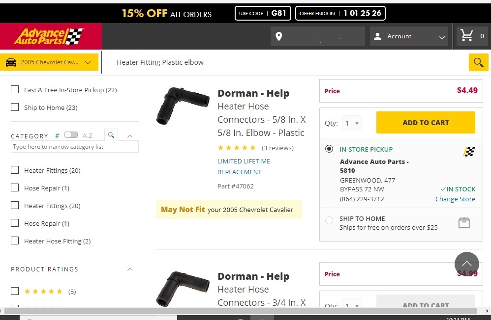

If you are not needing heat.
Not wanting to deal with it right now.
Why do you not "loop"/ "tie" the heater hoses together, this would bypass the heater core. Leaky problem solved for now!
The Medic
Tuesday, July 10th, 2018 AT 7:11 PM
PACKERS27
  • 230 POSTS
What hoses am I looking for? Is it the ones that is going through the firewall, next to oil fill cap?
Tuesday, July 10th, 2018 AT 7:23 PM
PACKERS27
  • 230 POSTS
Just cut them loose from the firewall and tie then in together?
CJ MEDEVAC
  • 11,004 POSTS
Correct!
The two hoses that enter the firewall to the heater core can be tied together.
Sometimes its easier to use one or maybe two elbows to make the loop.
Remember, you will not have heat!
Picture below.
The Medic
Tuesday, July 10th, 2018 AT 7:44 PM

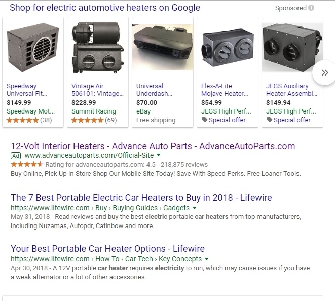

Being crammed in a small cozy cab, an option that might keep you somewhat warm if it comes down to it is an electric heater. Picture to give you some ideas below.
The Medic
Tuesday, July 10th, 2018 AT 8:09 PM
