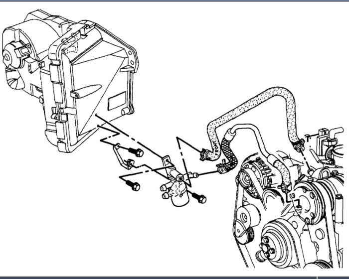

How to replace a heater control valve?
Wednesday, September 9th, 2020 AT 12:04 PM
3 Replies
DANNY L
MECHANIC
5,648 POSTS
Hello, I'm Danny.
Just a quick question do you have auxiliary heating, rear heating? Let me know and we'll go from there. Hope this helps and thanks for using 2CarPros.
Wednesday, September 9th, 2020 AT 12:12 PM
CM1
MEMBER
18 POSTS
No rear heat just A/C.
Wednesday, September 9th, 2020 AT 12:15 PM
DANNY L
MECHANIC
5,648 POSTS
Hello again.
I've attached the picture steps below on how to change the valve and its location. Hope this helps and thanks again for using 2CarPros.
