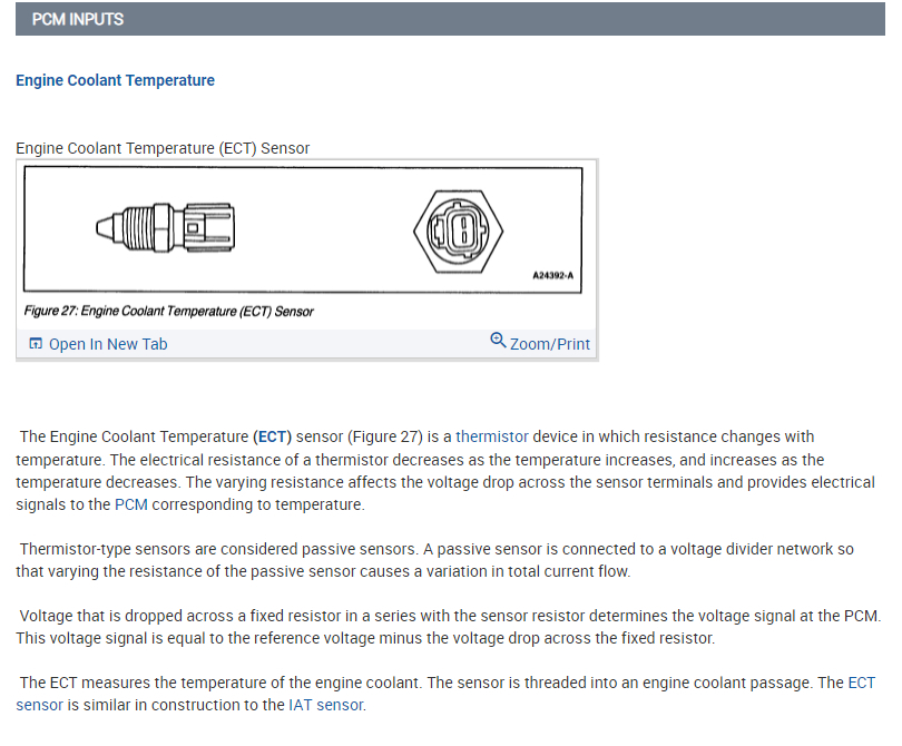

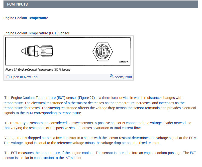

It is possible to have a faulty thermostat. As when you have a stuck closed thermostat the temperature between the two radiator hoses will be noticeably different.
Also if the temperature on the gauge fluctuates so much, it can be due to a faulty temperature sensor. Because regardless of overheating or not it should not fluctuates that rapidly.
https://www.2carpros.com/articles/how-a-coolant-temperature-sensor-works
https://www.2carpros.com/articles/symptoms-of-a-bad-coolant-temperature-sensor
It might be a good idea to run without the thermostat to see if you still experience similar issue. That way you can rule out the thermostat.
https://www.2carpros.com/articles/how-an-engine-thermostat-works
If the water pump does not circulate the coolant it could also make engine run hot also you might have temperature difference within the cooling system.
https://www.2carpros.com/articles/symptoms-of-a-bad-water-pump
Please let me know what you find.
