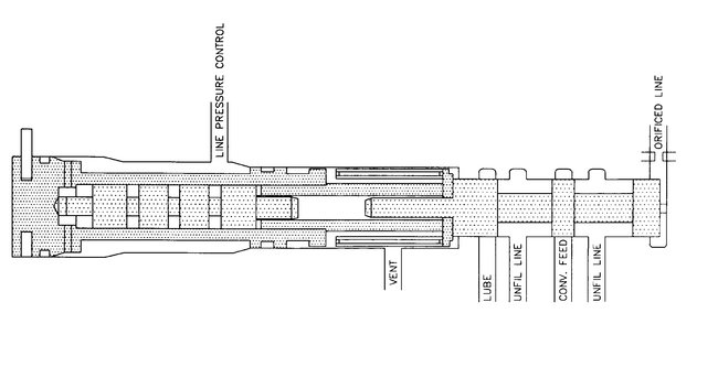

Have you checked for diagnostic trouble codes that are related to the transmission? I ask because it can be a few things. First, there could be a line pressure issue. Also, the fluid level could be low, but I assume you checked that after refilling when replacing the valve body. There is also a line pressure regulator. The pressure regulator valve controls line pressure to provide the correct pressure to apply clutches. If it is too high, you will get hard shifts. (Pic 1)

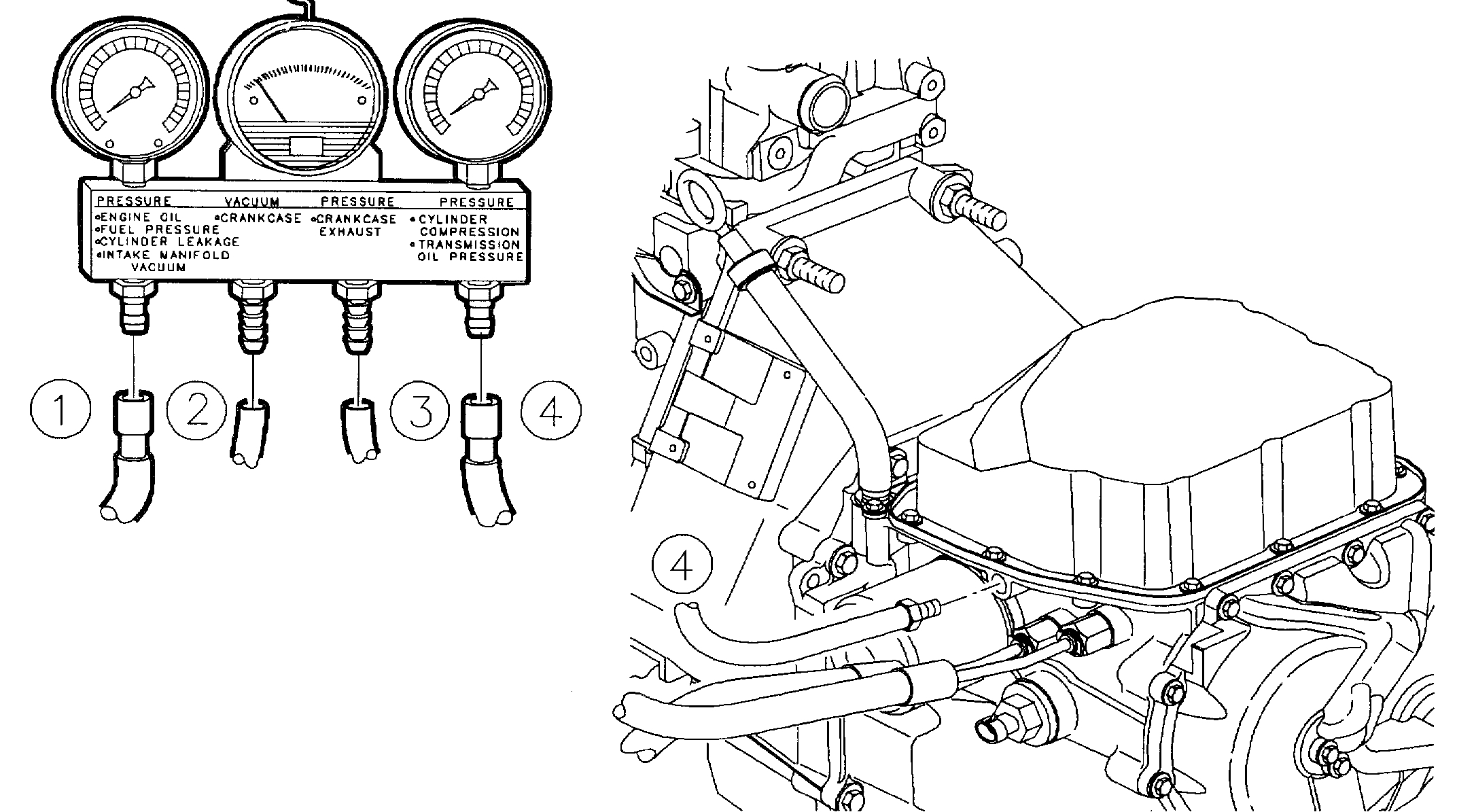

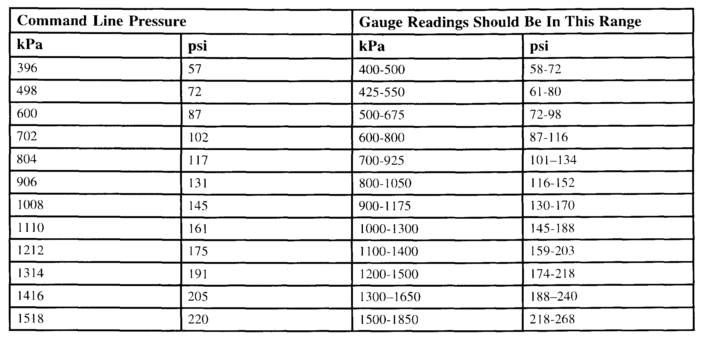

So, what I suggest is to check line pressure to see if it is within spec. Here are the directions for testing. Pics 2 and 3 correlate with the directions.

IMPORTANT: Be sure to perform both "Stepped Pressure Test" and "Maximum/Minimum Pressure Test" of the "Line Pressure Test."
STEPPED PRESSURE TEST
1. Run engine to bring transaxle to running temperature of 70°C (158°F).
2. Turn engine off.
3. Remove transaxle fluid temperature sensor and install pressure gauge.
4. Reinstall temperature sensor in wire harness.
5. Connect the Scan tool.
6. Key On engine Off. On first menu selection, select "Special Functions."
7. Select Line Pressure.
8. Transaxle in Park.
9. Scan tool will prompt you to start engine.
10. Select Run and the test will begin. The test will set engine speed to 1500 rpm and command line pressure up in steps from 396 - 1518 kPa (57 - 220 psi) in 100 kPa (15 psi) intervals.
11. As test is in progress, watch the gauge to assure the gauge readings follow the commanded pressures. Use a dry erase marker to mark the face of the gauge because it will be difficult to record the readings in time.
Pic 2
MAXIMUM/MINIMUM PRESSURE TEST
1. Oil pressure maximum and minimum values at idle should be checked using the following procedure:
IMPORTANT: For proper reverse operation, it is important to have at least 1206 kPa (175 psi) of system pressure in reverse at 70°C (158°F).
- With gauge connected and bans at operating temperature.
- With engine idling in Park, line pressure should be 400 - 600 kPa (58 - 72 psi).
- Remove line pressure fuse (10 amp TRS LP) UHJB.
- With engine idling in P (Park), pressure should be 1206 - 1690 kPa (175 - 245 psi).
NOTE: High value may be slightly lower if transaxle temperature is greater than 110°C (230°F).
IMPORTANT: With engine in Park, and the 10 amp TRS LP line pressure fuse removed. Minimum pressure should be 1206 kPa (175 psi).
2. Remove pressure gage, install temperature sensor, use Saturn P/N 21485278 sealant with Tenons on threads (or equivalent). After the sensor has been connected, clear diagnostic trouble codes caused by having the sensor disconnected.

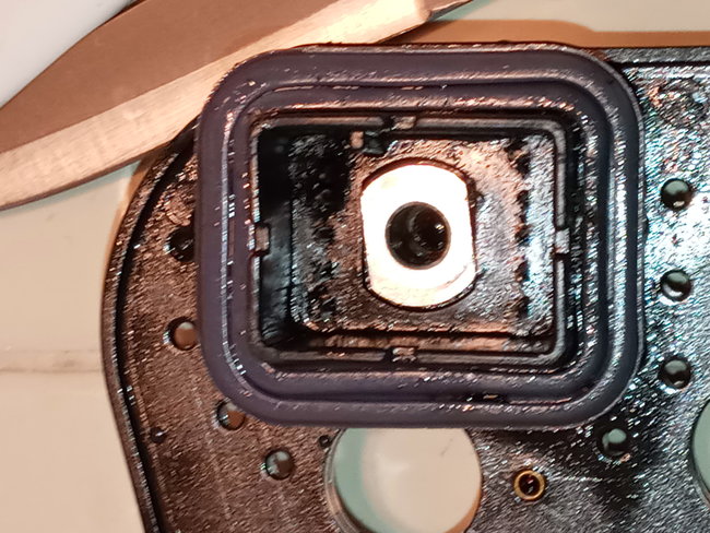

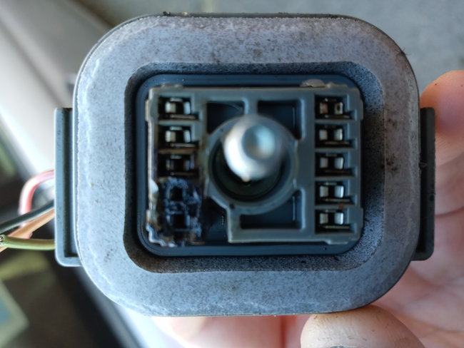

Have no line pressure tester and no good scan tool have cheap obd 2 scanner $20.00 one. So if line pressure to high or to low what would solve line pressure issue could also it be input output shaft nuts loose or wiring issue? I had to splice and replace bus plate connection plug do to lp wires were cut and 2 shift solenoid wires where cut at connector plug to bus plate was stuck in 4th gear. Before I fixed wiring and was not hard slam into reverse until after I fixed wiring? Also just replaced valve body with one off online.
Wednesday, November 18th, 2020 AT 8:42 PM
RODDNEY KINCAID
  • 17 POSTS
Also when I replaced the wiring harness to bus plate the red and blue lp solenoid wire connection in both bus plate and plug to bus plate were completely fried. Could it have burnt pins in PCM for lp solenoid? The lp fuse is good and did not blow if so will PCM cause issue for hard shifting? This is old bus plate and harness sense didn't blow lp fuse could it have went straight to PCM?
Wednesday, November 18th, 2020 AT 9:12 PM
  • 110,192 POSTS
As far as a control module being the cause, yes it's possible. In all honesty, without scanning the system with a scan tool that can read all types of codes, this becomes a guessing game.
As far as the pin being burnt, that certainly could have caused a problem but since it is to the IP, I don't think it is causing this issue.

KEN L
  • MASTER CERTIFIED MECHANIC
  • 55,097 POSTS
Those burnt pins don't look good. I would fix those first also let us know what color are the wires so we can see what they go too.
