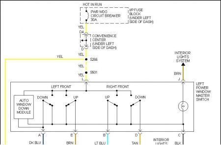

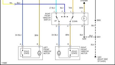

1999 GMC Truck window schematics for motor
ELIZABETH64
  • 1999 GMC TRUCK
  • V8
  • FWD
  • 148,000 MILES
I need to see the schematics on a window motor. The window fell off the track and there is loose wires. Neede to see how wires are put together to raise the electric window

BLUELIGHTNIN6
  • 16,542 POSTS
https://www.2carpros.com/forum/automotive_pictures/261618_Noname_982.jpg
https://www.2carpros.com/forum/automotive_pictures/261618_Noname2_275.jpg
