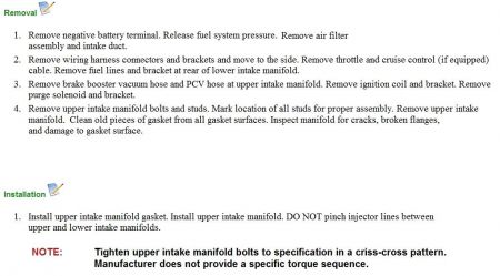

how to take the head manifold off to get to the head gsaket
