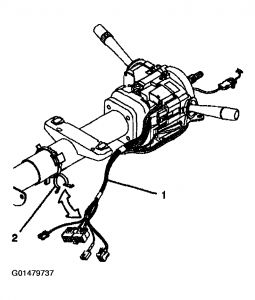

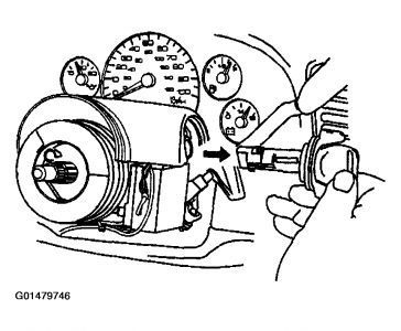

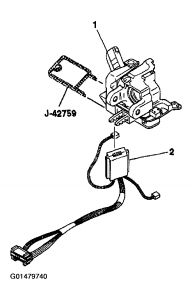

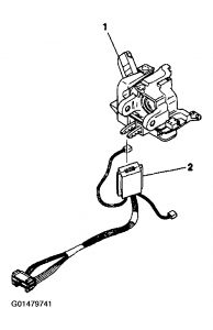

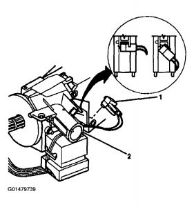

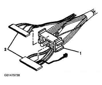

BMRFIXIT
  • 19,053 POSTS
https://www.2carpros.com/forum/automotive_pictures/99387_Graphic_65.jpg
https://www.2carpros.com/forum/automotive_pictures/99387_Graphic1_711.jpg
https://www.2carpros.com/forum/automotive_pictures/99387_Graphic2_325.jpg
https://www.2carpros.com/forum/automotive_pictures/99387_Graphic3_142.jpg
https://www.2carpros.com/forum/automotive_pictures/99387_Graphic4_63.jpg
https://www.2carpros.com/forum/automotive_pictures/99387_Graphic5_38.jpg
Thursday, April 22nd, 2010 AT 7:10 PM
SZALKUSKT
  • 274 POSTS
Thanks for the photos. I am wondering is the ignition switch separate from the ignition cylinder? Also, do you have a diagram relating to the procedures for removal of the components described in your reapair steps?
-1
Thursday, April 22nd, 2010 AT 7:32 PM
BMRFIXIT
  • 19,053 POSTS

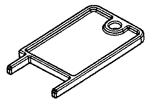

You have an ignition switch and ignition cylinder lock
Need special tool

Can I just install an ignition switch and try and see if it fixes the problem? Is the special tool for removing the ignition lock cylinder? Also can't you just use an allen key wrench or something to remove the ignition lock cylinder?
-1
Friday, April 23rd, 2010 AT 2:42 AM
BMRFIXIT
  • 19,053 POSTS
Most common to be the switch and not the cylinder lock
Inspect closely the wiring harness too
You can use whatever available to you and make your own special tool knowing what it look like
