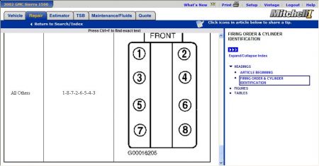

What do you recommend on trouble shooting since my diagnostic code at autozone read Cylinder 3 misfire. Code# P0303
How do I locate cylinder 3 to check the spark plugs/wires? Are they numbered?

For what liter engine?
You should check spark plug/wire, fuel injector, and compression for #3 cylinder.

5.3L V8
Wednesday, February 10th, 2010 AT 8:54 AM
  • 75,992 POSTS
5.3 liter
https://www.2carpros.com/forum/automotive_pictures/12900_fo5_1.jpg
