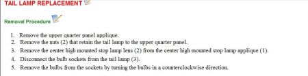

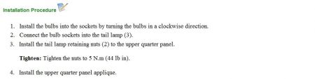

My tail light and parking lights are out how do I change the bulb
Wednesday, October 27th, 2010 AT 8:09 PM
