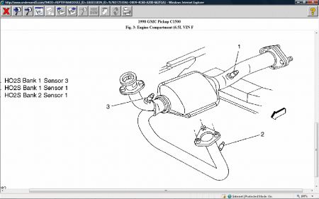

it's in the distributor, test like this: TESTS W/CODES - 5.7L -1998 GMC Savana G1500 Page 1 of 1 DTC P0341 - CAMSHAFT POSITION SENSOR (CMP) CIRCUIT PERFORMANCE NOTE: For circuit reference, see WIRING DIAGRAMS - 5.7L article. Circuit Description If cam/crank sensor pulse ratio is skewed, DTC will set. Fault is not a solid or consistent failure and may not act the same way twice. Conditions for setting this DTC:  With engine running, CMP sensor reference pulse is not detected at correct interval. Diagnostic Procedures 1.Perform POWERTRAIN ON-BOARD DIAGNOSTIC (OBD) SYSTEM CHECK , then go to next step. 2.Check for intermittent short to voltage or electromagnetic interference (i.e., wires running along side spark plug wires, high power transmitters such as mobile radios) in camshaft position sensor wires. If a problem is found, go to next step. If no problem is found, go to step 4). 3.Repair short to voltage or EMI interference as necessary. After repairs, go to next step. 4.Using scan tool, select DTC, CLEAR INFO. Start and warm engine to normal operating temperature. Select DTC, SPECIFIC, then enter this DTC. Operate vehicle within the conditions for setting this DTC. If scan tool indicates that this test ran and passed, go to next step. If scan tool does not indicate that this test ran and passed, repeat step 2). 5.Using scan tool, select CAPTURE INFO, REVIEW INFO. If any undiagnosed DTCs are displayed, go to applicable DTC test. Diagnostic Aids An intermittent may be caused by a poor connection, rubbed-through wire insulation or a broken wire inside insulation. Inspect harness connectors for backed-out terminals, improper mating, broken locks, improperly formed or damaged terminals, poor terminal-to-wire connection, and damaged harness. If DTC is intermittent, see TESTS W/O CODES - 5.7L article. 8/4/2008
https://images.2carpros.com/forum/automotive_pictures/62217_O2_1.jpg

MIKE SMITH
Was retrieving 3 codes, PO340, PO137, PO341.
Replaced the Hall effect switch, Replaced the O2 senser.
Check engine light came back on, now reading a PO340 only.
What should be my next move on this????
