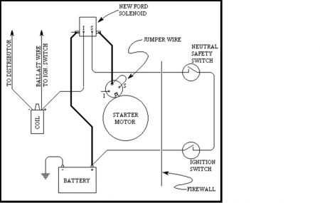

1981 CHEVY TRUCK WITH A REBUILT 1979 MONTE CARLO ENGINE 305 V8 . HASTIATES TO START AFTER WARM. I REPLACED ALTERATOR,STARTER,NEW BATTERY.DO U HAVE ANY SUGESTIONS?IF U DO PLEASE HELP.

In the old days, there were hot restart issues with chevy. Some wired up a ford starter relay on the fender well, diagram below. Because I don't know the exact cause of problem, I can't say the procedure is a fix. The diagram came from chevelles.com. I've seen timing issues that would load the starter to the point it had trouble cranking.
https://images.2carpros.com/forum/automotive_pictures/512072_chevy_hot_start_issue_1.jpg

thanks for your help.but do you think it could be the relay?

Are you talking about the starter solenoid, you don't have a starter relay. It's possible, it could be the solenoid. Sounds like something is getting too hot?
