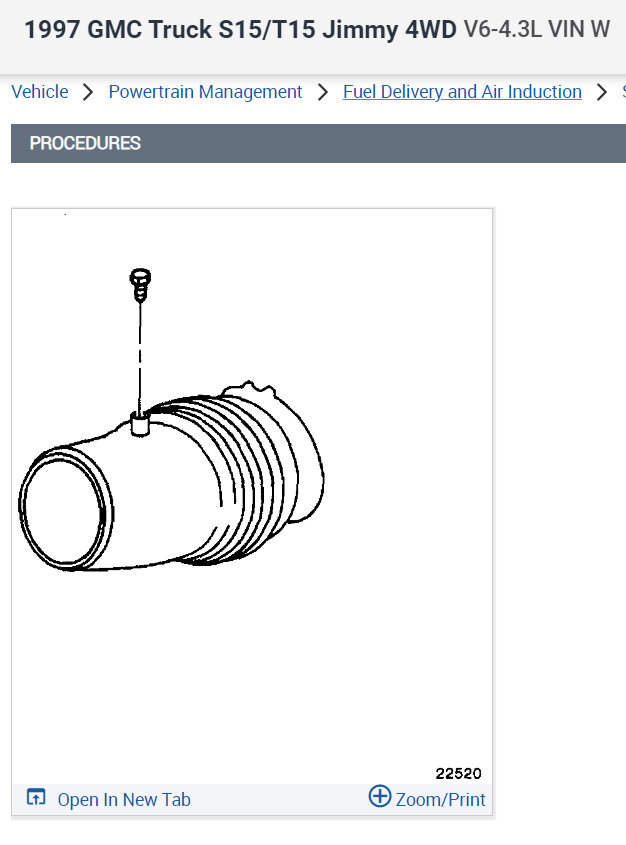

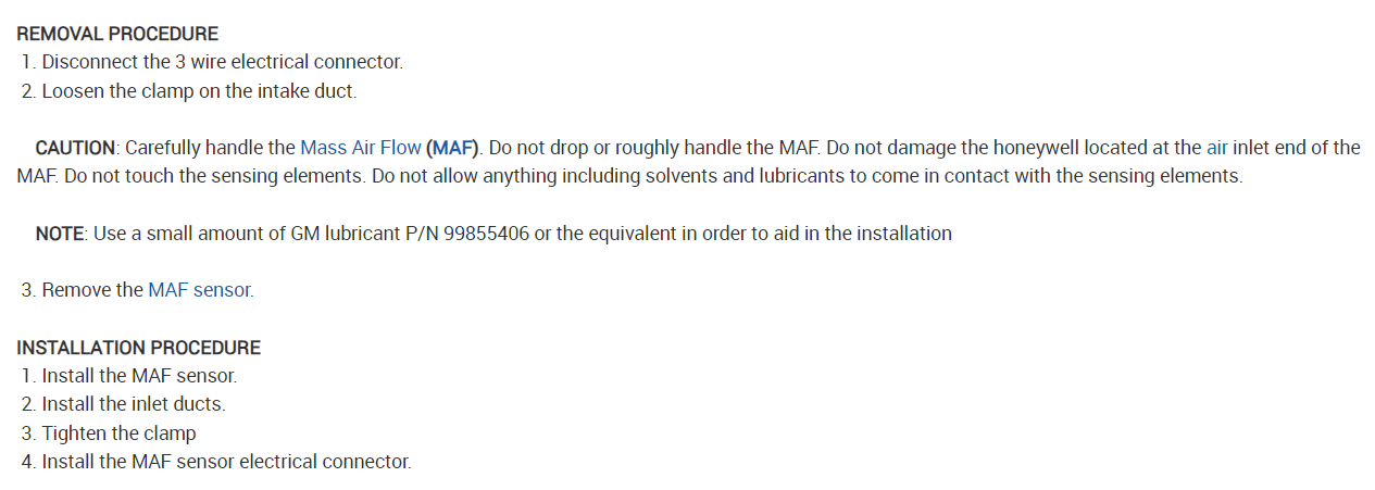

What does p0171 and p0174 mean what part is it?
Wednesday, November 28th, 2007 AT 7:33 PM
BMRFIXIT
MECHANIC
19,053 POSTS

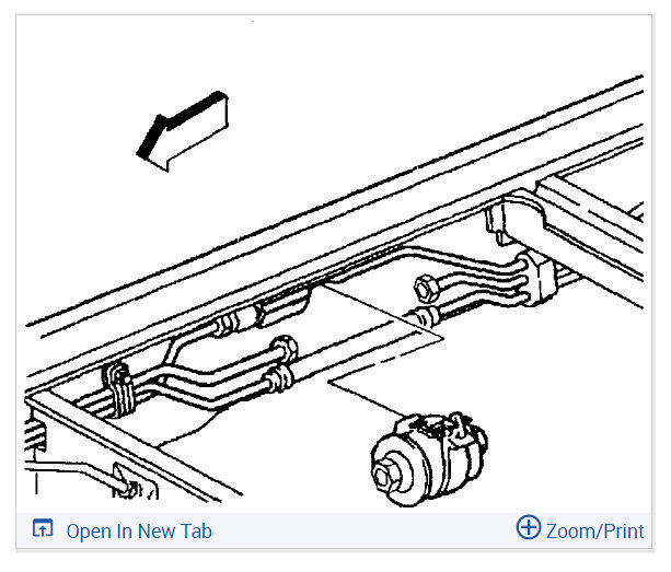

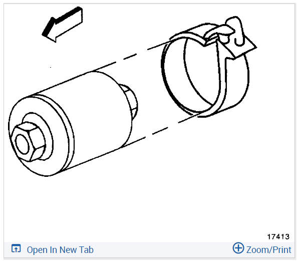

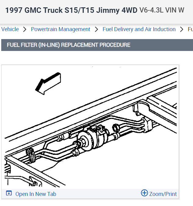

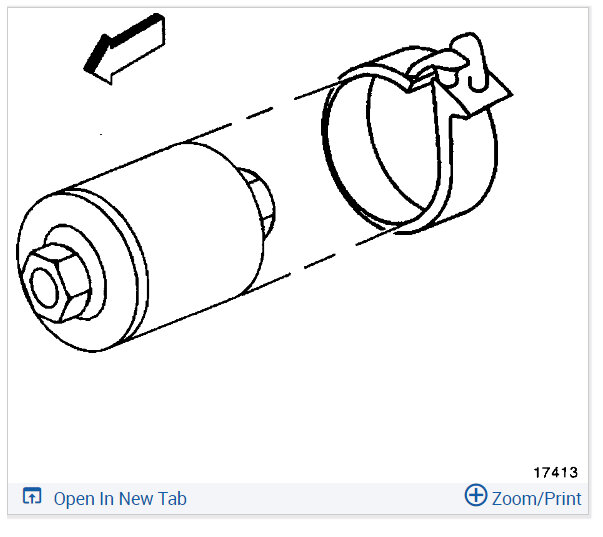

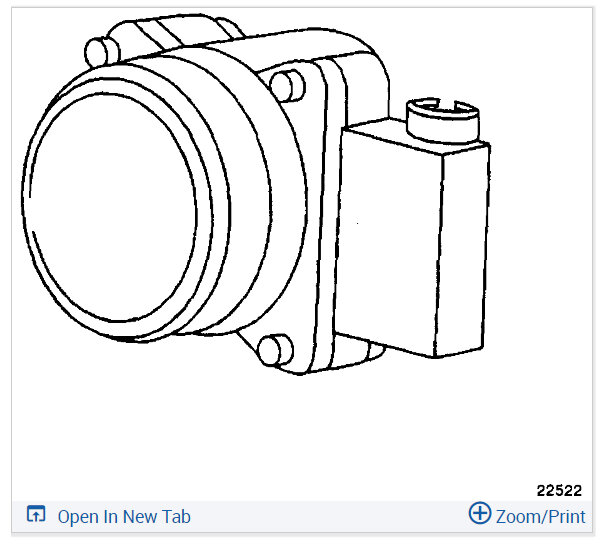

The codes P0171 and P0174 both indicate that the engine's air-fuel mixture is running too lean. Here is a guide to help you fix it but I can tell you a clogged fuel filter, vacuum leak or a bad MAF sensor can cause this problem.
https://www.2carpros.com/articles/repair-lean-mixture-codes-p0171-or-p0174-on-some-manufacturers
Here is the locations for the MAF sensor and fuel filter. Check out the images (below). Please let us know what happens.
Images (Click to make bigger)
