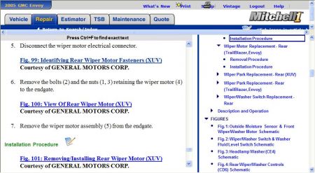

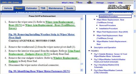

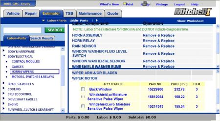

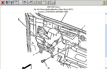

Where is the motor for the rear wiper on a 2005 GMC Envoy and can I change it myself? How much would one cost new and used?
Friday, December 12th, 2008 AT 11:23 AM
MECHANIC
75,992 POSTS
You should be able to just remove the back panel the cost- see below for a new one-shop around
