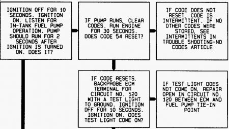

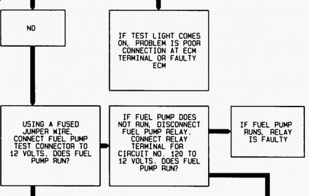

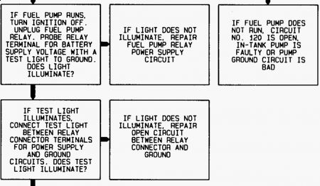

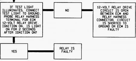

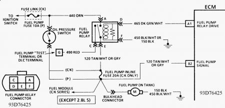

When I start engine I have to hold the throttle open for it to run. It runs choppy and pops back through throttle body. It has code 54 stored (low fuel pump circuit voltage) what could cause this? Thanks
Friday, August 28th, 2009 AT 1:12 PM
3 Replies
MERLIN2021
  • 17,250 POSTS
Code 54 will set if ECM does not see 12 volts on fuel pump signal voltage monitor during the first 2 seconds after ignition is turned on.
Is this a 5.7? 5.0? The diagram below is 5.7 circuit.

This chart is for both!
