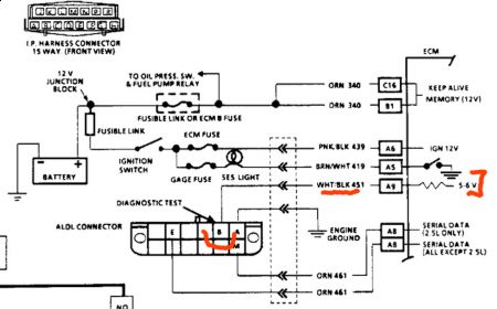

This truck has had the computer replaced with a new one(same prom) and it still doz this: high idle, pinging, dies check engine light is on and of the pinging is when you put your foot in it. And with the scanner reads no prob. Found. Can not get the light to blink code 12 if I could get the codes I could out of it then I could fix it HELP! And thanks. I cant afford to donate much to day.

Here is how you get the codes
https://www.2carpros.com/articles/buick-cadillac-chevy-gmc-oldsmobile-pontiac-gm-1983-1995-obd1-code-definitions-and-retrieval-method
The ECM incorporates a diagnostic program which, when activated, will flash codes stored in the trouble code memory through the "CHECK ENGINE" lamp. A diagnostic connector, located under the instrument panel, is used to activate the self-diagnosis system. The connector,allows access to system circuits and contains a test terminal which, when grounded with the ignition on and engine stopped, causes stored trouble codes to be flashed on the "CHECK ENGINE" lamp. The ALDL is under the dash on the drivers side near the e-brake lever.

I did get the chart and im at : back probe ckt 451. Witch one is that? Exhast good pressure and doz not smell like coolent the cat has been replaced. I think the ecm is cawzing the IAC. Valve to act up. And I did change the valve still the same I think this is the high idle prob. I want to send ya some more money do I start over with same title ( 1989 gmc code 12)?

451 is the white/black wire. The connector is on the driver side near the ebrake lever.
https://www.2carpros.com/forum/automotive_pictures/30961_gmc_1.jpg
