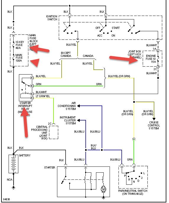

Basically I put new fuel pump in it its getting fire tested it for that its getting fuel tested. That but it will not start. What's going on

Scan for codes and check fuelpressure with a gauge autoparts rent it. Check fuses underhood an din car.

Put it on a code reader nothings coming back checked all the fuses and relays its good

I screwed up sorry, check battery for condition including load test. Autoparts can do this or a tire store. Then I fyou have anti theft try resetting it if no manual look online. Check items in pic as well for relay try a like one
