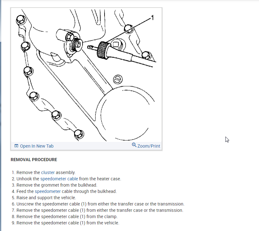

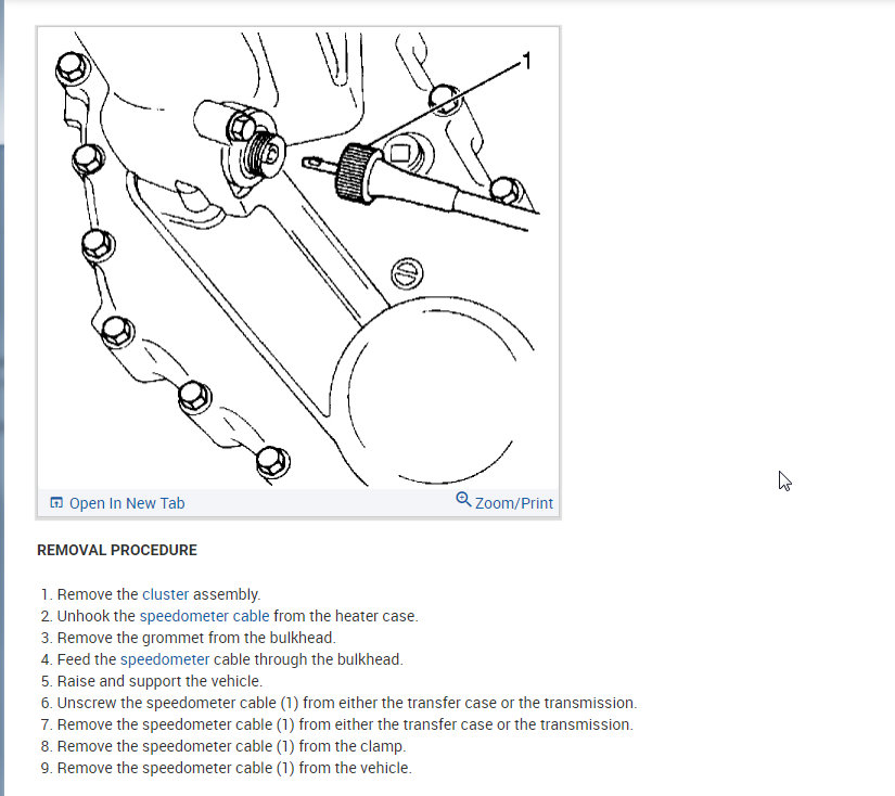

My 1998 Chevy Tracker (your Chevy drop-down doesn't list Tracker, so had to click on Geo) has developed a really annoying sqeak-type noise right behind the dash panel. Even though I'm a girl, I know its the speedo cable because it gets more intense the faster I go and stops when the car isn't moving. I've traced the cable but can't access it to lubricate it behind the dash panel, even with my small hands. Do I have to drop the whole steering column and dash panel to lubricate the speedo cable? Seems as though there should be an easier way than that! Can somebody tell me how to lubricate the cable, or must I start driving with earplugs? So far, it doesn't seem to be affecting the actual performance of the speedometer. No bouncing or anything. Its ust that blasted noise! I'd appreciate any help, if I have to break a nail, so be it! Kate
