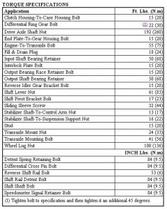

All I need tyo know is what is the torque specs. On the clutch bolts. And I need to know the torque specs on the axle shafts nuts.

Sunday, August 17th, 2008 AT 3:20 PM

Hey thanks for such a fast response iI have bein trying to find the specs for the last two weeks. Thanks again. And have a good day.
