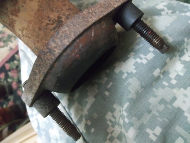

I am taking my exhaust manifolds off and started to disconnect the mid pipe and there was gas that covered the nut that I took off the flange. Why? And also been having a po171 and a po174 code.

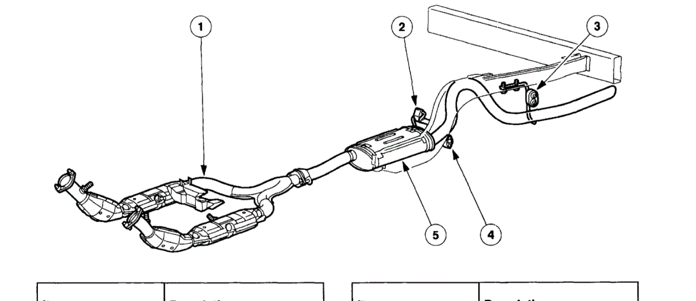

Is it possible for you to take a pic of where you found the fuel and upload it for me to see?
Also, I attached a pic of the exhaust below. Can you let me know which section is the one you are referring to? I ask because looking at the pic, I see a Y pipe that attaches to one other part.
Make sure to inspect the fuel line near where you found the fuel.
Let me know. Also, let me know if you have other questions.

I noticed it when the nuts came off the manifold.

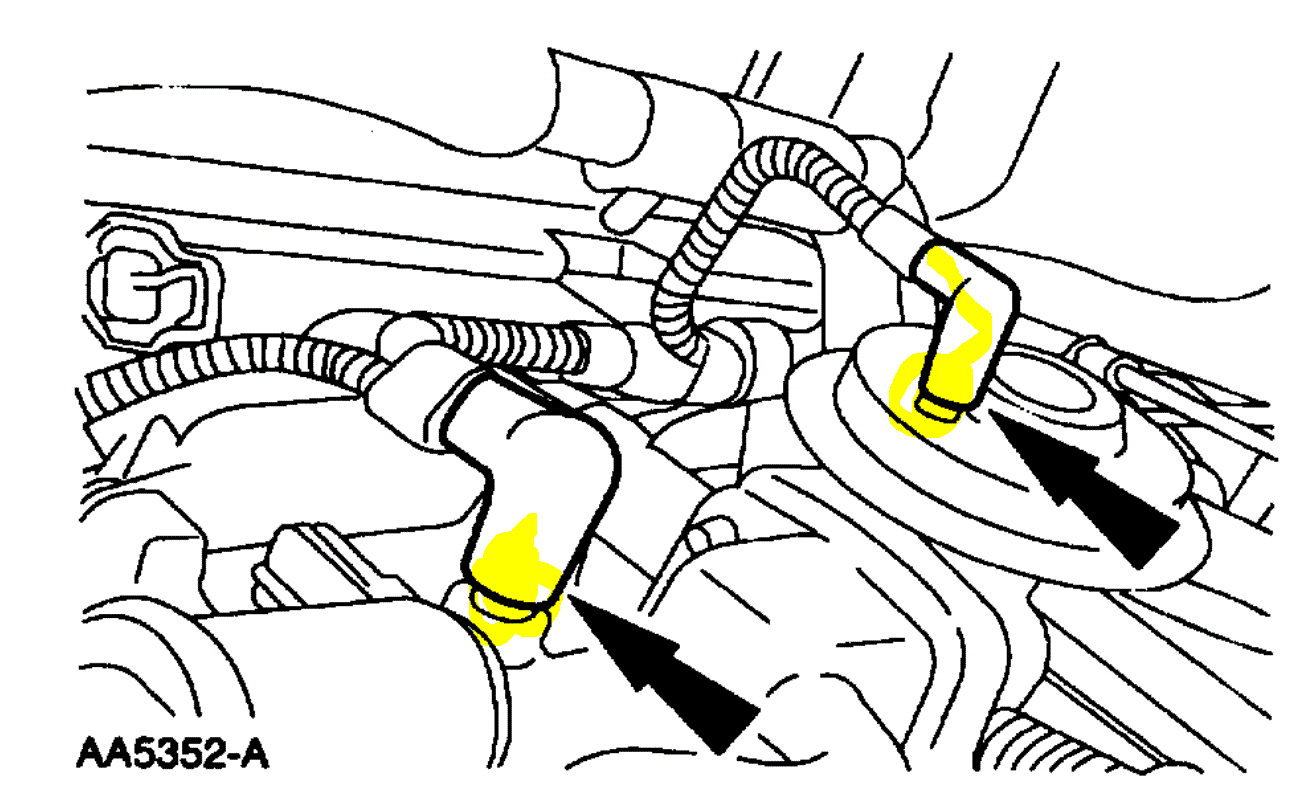

The 401 deals with the EGR. Check to make sure the vacuum hose isn't disconnected to it. That can lead to a lean condition, but it wouldn't cause the fuel leak issue. Also, there could be a restriction (carbon) in the intake where the EGR is mounted.

The EGR is mounted on the intake manifold. Check to make sure the vacuum hoses are attached, not loose, and not leaking due to damage.

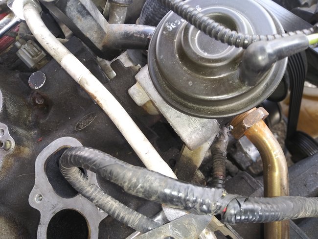

It's connected the gasket for the EGR was told some of the outer coating was coming off so I scraped the rest off and it had some metal spikes on it bit. I just bought a new gasket.
Sunday, March 7th, 2021 AT 6:21 PM
  • 110,192 POSTS
Check to see if there is a vacuum leak at the gasket. Also, when you had it off, did you check to see if there was a build-up of carbon in the intake or EGR?

EGR was pretty clean. I take it off from time to time to clean it and the down tube looked clean.
Sunday, March 7th, 2021 AT 6:28 PM
  • 110,192 POSTS
Was it clean in the intake? Also, if you apply vacuum, does the pintel move?

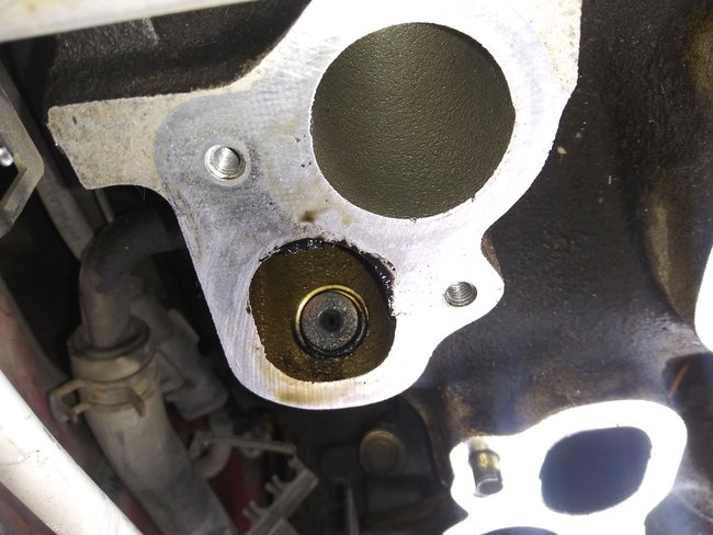

Here.
Tuesday, March 9th, 2021 AT 9:51 AM

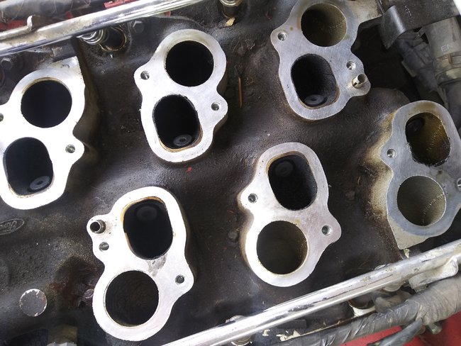

Every passage way is clear on the intake.
Tuesday, March 9th, 2021 AT 9:54 AM
  • 110,192 POSTS
It looks near new. You must have taken care of it. Did you check the EGR for operation?

Did not check the EGR to hold vacuum and where the EGR bolts to is on the engine block should I take that part off and I have tried to move the diaphragm of the EGR with my mouth and it does move but tomorrow I will go to the auto parts store to use one of their vacuum and yes I used to change the oil like every month and use royal purple, lol.
Tuesday, March 9th, 2021 AT 5:50 PM
  • 110,192 POSTS
Check to see if the EGR moves when under a vacuum. Also, I've used Royal Purple for years. Great stuff. As far a the diaphragm, I don't believe you can remove it.
