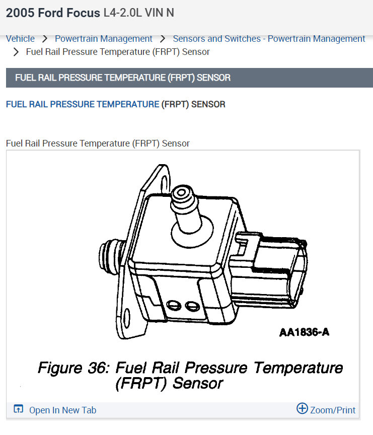

On the car listed above is there a fuel temperature sensor. I got a p0182 code fuel temperature sensor A circuit low.

Yep, it is integrated into the fuel pressure sensor. Here is the location and how to change it out. Check out the images (below). Let us know if you need anything else.

Okay, yeah, that is what I changed, the fuel pressure sensor.

My sensor doesn't look like that. This is a 05 saleen focus 2.0.

Can you upload an image of the sensor?
