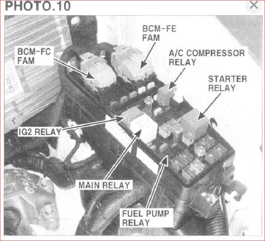

Is there a safety shut off switch for this vehicle?
Jun 2, 2019 at 3:12 PM
Hi Amber lynn,

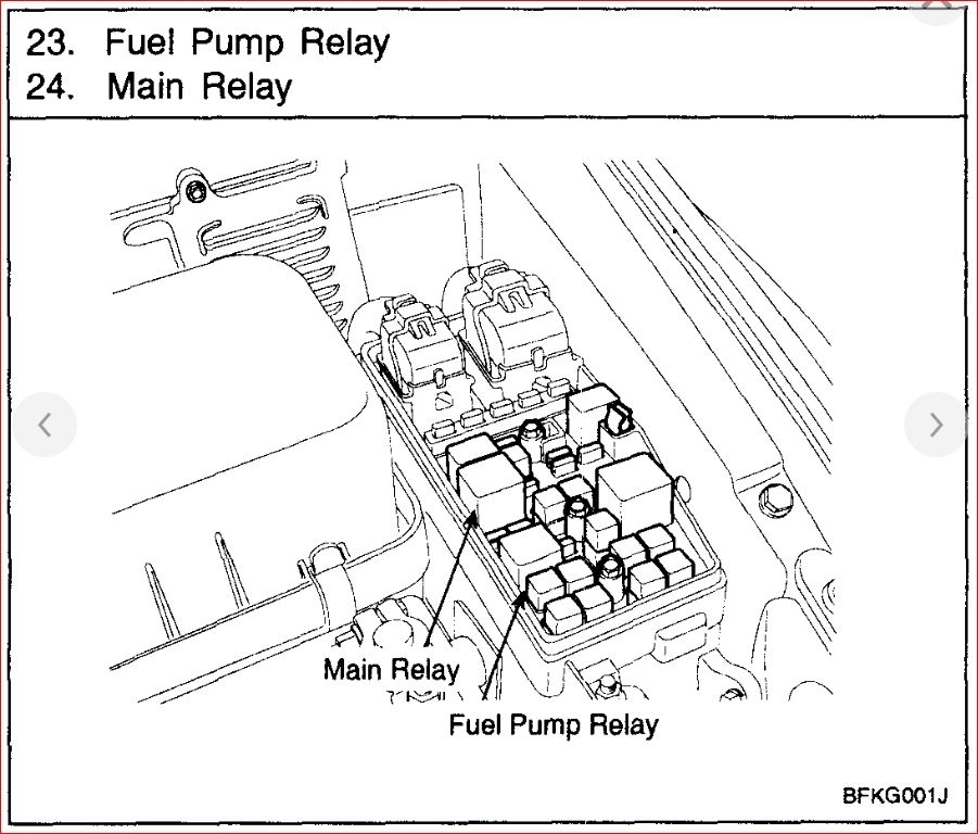

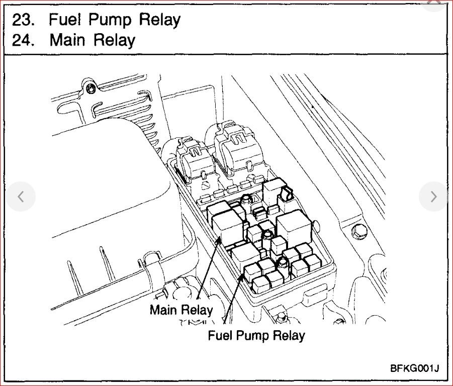

Are you referring to an actual switch to shut off power to the fuel system? If so, there is not a switch but there is a relay for the fuel pump. I attached the location to this post. If you pull this relay, then the fuel pump will not have any power and not be able to turn on.
Let me know if you need something else or if I am not understanding what you are after. Thanks
