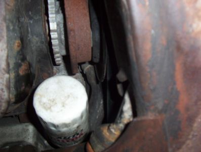

Because you are a pro car technician, I thought that you have already changed an oil filter on a Windstar. Because Windstar are so popular in USA, there's a lot of Windstar. So I send you the picture of my oil filter under the engine. And you will judge if it is possible to remove it with the plier. Personnally, I think that it's impossible to remove it with the plier.

I've changed my share, but my photographic memory can't hold every vehicle. Spend a little time and look around you. Quite a few huh? Not to mention each model will vary with different engine sizes and options that change the access. Great way to show appreciation.
With the pliers, you can get in there. Instead of grabbing perpendicular to the filter body you can get a good bite with the teeth at just a slight angle to get it loosened enough to turn it off by hand. But like you say the socket style would better serve you.

Yes, I have thought about grabing in direction of the filter, but I will have less torque. It will require a lot of force. Definitively, using a socket with an extended ratched wrenche will be the best.

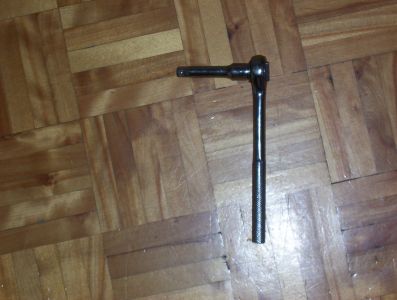

Finally, I succeeded in removing my Ford Windstar's oil filter by using the End Cap Oil Filter Wrench. There is it:
https://www.2carpros.com/forum/automotive_pictures/104484_KDT2790_1.jpg
The brand is KD. Part number is CAN2790. The size is 3".
I have used also a 3/8" ratchet wrench and its extension:
https://www.2carpros.com/forum/automotive_pictures/104484_000_1632_1.jpg
With this Cap Wrench, it was so easy to remove the oil filter. It was impossible with my old band wench. Now my car can run with new oil. Thanks to Paul for its advice.
