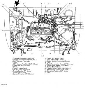

Where is the PCM located on my 1999 windstar?
Wednesday, December 17th, 2008 AT 2:43 PM
DAVE H
MECHANIC
13,384 POSTS
Powertrain Control Module (PCM) (3.0L)Behind right side of dash, through firewall. See Fig. 1 .
Powertrain Control Module (PCM) (3.8L)Behind right side of dash, through firewall. See Fig. 2 .
