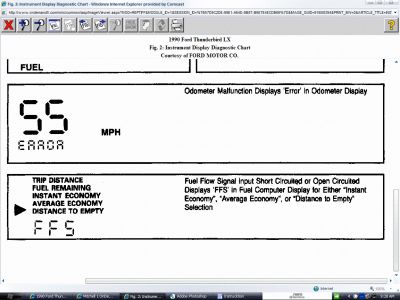

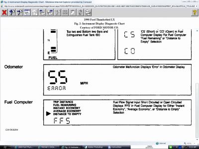

What does "FFS" mean? It sometimes appears on the digital display, and goes away.
