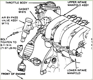

My idle is too high, and I think its cause the idle air control valve needs to be cleaned. I dont know where the valve is located on my car though. Can someone post a picture or tell me where its located?

This is looking from behind engine from passenger side.
you may find better on google.
