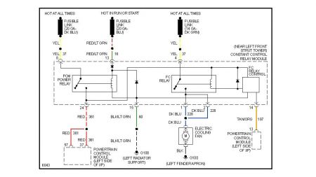

Where is the fan motor relay located in this car and what does it look like?
Wednesday, May 21st, 2008 AT 9:21 PM
MECHANIC
75,992 POSTS
Its near left front strut tower CCRM see below
Try direct power from battery-positive cable to dark blue wire at fan motor and negative cable to black to insure its not the fan motor.
