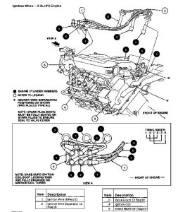

I have a 2002 taurus which is giving the code that there is a misfire on the #2 plug. I was assured that it was most likely just a bad plug or wire but when I went to change the plug out I could not even get to it. Itook off everything I could see that was in the way but still to no avail. Is there an easier way to do this and if so how. Even the dealer I called said it was very difficult. They wanted 150.00$. Thanks in advance for your help.

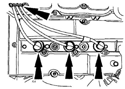

SERVICE WRITER
  • 9,123 POSTS
No patience is no a good quality with today's auto.
This is the left side for the wires:
http://www.2carpros.com/forum/automotive_pictures/30961_02left_1.jpg
And the Right side:
http://www.2carpros.com/forum/automotive_pictures/30961_o2right_1.jpg
http://www.2carpros.com/forum/automotive_pictures/30961_02wires_1.jpg
The plugs are deep in the holes.
A misfire can be caused by a multitude of things including a carbon build up, incorrect air-fuel mix from a variety of sources. Secondary ignition issues
But like I said, if the plugs and wires are old, then it would be a good place to start.

STIDD23
The layout helps but, I have tried to get to the back plugs and you have to take off the exhaust manifold? I think that is correct and then the coilpack but I cant seem to get the top cover & all the other crap off to get to it. What I was wondering was is there an easy way to get to it? Thanks.
