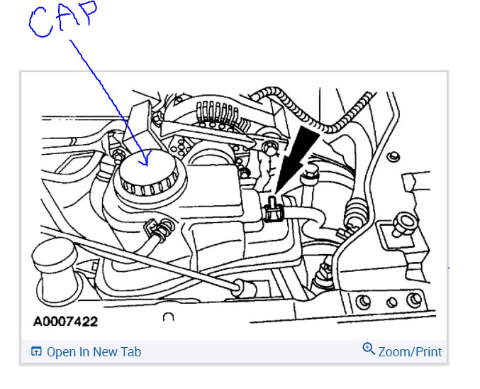

My car coolant spills out od radiator cap after driving for a bit. I have replaced the thermostat and it still does it. It looks like there is a lot of pressure that builds up to cause this. Do you have any suggestions on where to go from here? Here is the radiator cap?

Check that the radiator is not part blocked internally, replace the pressure cap and I would also get a head check done, this is a simple chemical test to check for exhaust gas in the cooling system. Here is the cap location is the diagrams below. Check out the diagrams (Below). Please let us know if you need anything else to get the problem fixed.
