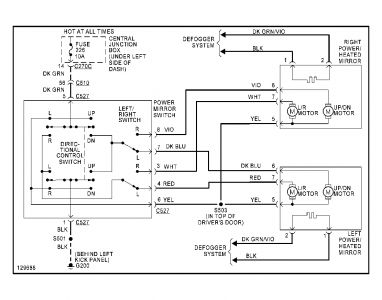

2001 Ford Taurus side mirrors and trunk light
DWHITSEL
MEMBER
2001 FORD TAURUS
Electrical problem
2001 Ford Taurus 6 cyl Front Wheel Drive 170175 miles
side mirrows and trunk light not working fuse checks out okay under dash
Do you
have the same problem?
Saturday, January 3rd, 2009 AT 12:07 PM
BMRFIXIT
MECHANIC
19,053 POSTS
Check fuse using a test light u should have power at it with key on
also check ground wire behind left kick panel
as for the trunk start with the bulb
