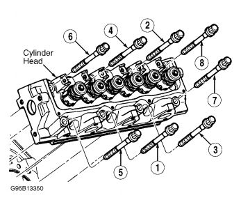

WHAT IS THE SEQUENCE AND AMOUNT OF FT LBS TO TORQUE THE HEADS

1. 37 LBS
2. BACK OFF 360 DEGREES
3. 22LBS
4. ROTATE 90 DEGREES
5. ROTATE ADDITIONAL 90 DEGREES
THIS IS FOR A 3.0 VIN U & 2

BOLTS NEED TO BE REPLACED WITH NEW
