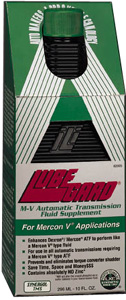

Well you need to drop the transmission pan to change the oil in the trans. As far as brand that isn't so important I use Valvaline but as long as it is Mercon V then that is what is most important. Now like I said you can use lubegard fluid modifier to change the fluid to perform like Mercon V. It is lubegard #62005. Here is a pic of it and yes it works. This all you would have to do is add it to the transmission and forget about it.

In the future, if i need to add transmission fluid, is that ok if I add Mercon V? You know in that case, two fluid will mix.
Apr 13, 2021 at 5:38 PM
RACEFAN966
  • CERTIFIED EXPERT
  • 5,029 POSTS
Yes once you use the Lubegard you can just add Merc. V as you would normally.
