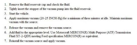

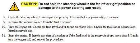

The repair manual I look at stated the rack should be bleed can u help me. How is it done.
