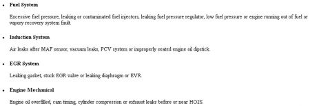

I went to have my tarus safety inspection done. It failed because of the following.
Code number Description of the DTC
P1151 P11XX Manufacturer Controlled
Fuel and Air Metering.
Could you please tell me where this is and how to repair it?
Thank You!
Thursday, August 14th, 2008 AT 6:37 PM
SERVICE WRITER
MECHANIC
9,123 POSTS
This needs to be troubleshot by someone capable of doing so.
there are many causes including:
