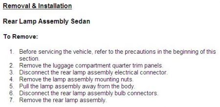

How do I replace my brake lights

Thanks for the donation. I found some info on lamp assembly removal.
