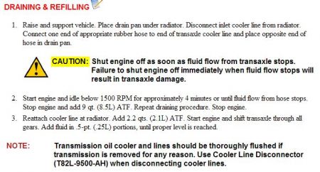

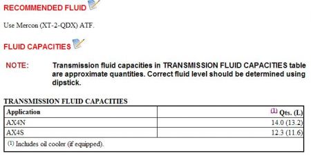

How should I change the fluid in the 95 Taurus automatic transmission? What is the best type of fluid?

Which hose is to be dissconected, the upper or lower?
