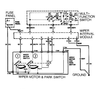

My wipers dont wsork and we tried to replace the motor, the governor inside the cab and the switch witch tells me its a wire problem. I have power in the motor area and no power from that point to the inside of the car as far as the wires go. What do I do. I have been trying to figure this out for weeks now and am lost.

Start with the fuses

What I meant is start with the fuse checking the power
do u have power at the fuse then move on to the next following the wiring diagram

Wher do I find the diagram you sent in the first reply?

I can e mail it
just let me know where

My email is jschi7@aol. Com and thank you. Also how do I check my ground? I am a female trying to fix her own car and having a rough time doing so.

EMAIL WAS SENT
need to use a 12 volt test light
know if you are to test the ground place the clips on a power (B+)
when u touch ground with the test light it should lights up if not then bad ground
switch the clips to a ground (B-)
check for power light should light up where you have power
start with the fuses check for power
https://www.2carpros.com/forum/automotive_pictures/99387_Graphic1_24.jpg
https://www.2carpros.com/forum/automotive_pictures/99387_Graphic2_16.jpg
