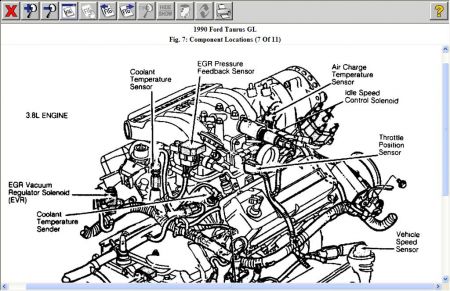

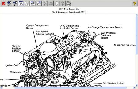

Where is the air charge temperature sensor located on the engine of a 1990 Ford taurus / 3.8 V-6

Here you go and good luck
3.0L on right top of engine
3.8L on right front of intake manifold
