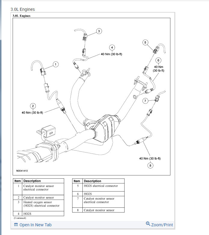

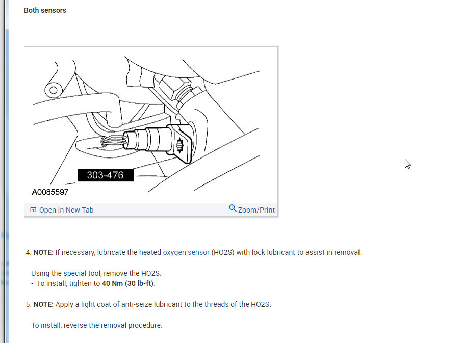

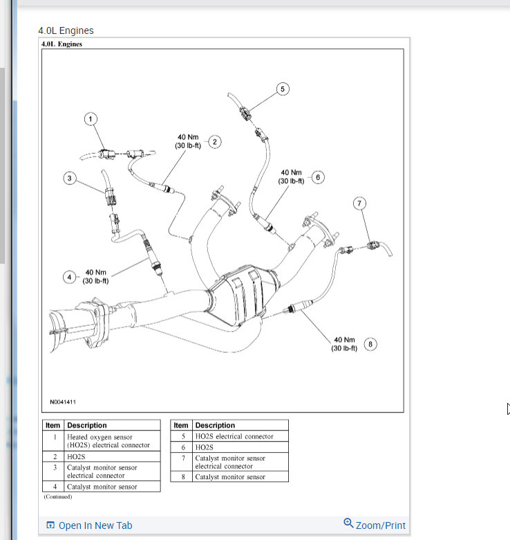

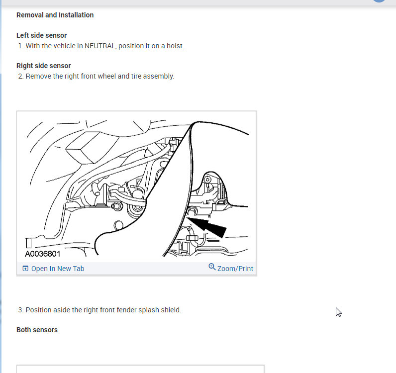

I need to change the bank 1 sensor 1 oxygen sensor?
Thursday, October 1st, 2009 AT 10:31 AM
MECHANIC
18,907 POSTS
Yes. Here are some guides that will help with this as well:
https://www.2carpros.com/articles/how-to-test-an-oxygen-sensor-02-sensor
https://www.2carpros.com/articles/how-to-replace-an-oxygen-sensor
Below you will find the process from the manual that will help with replacing these sensors.
Please let us know if you have other questions. Thanks
