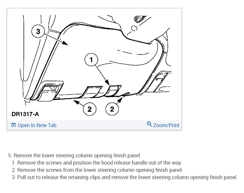

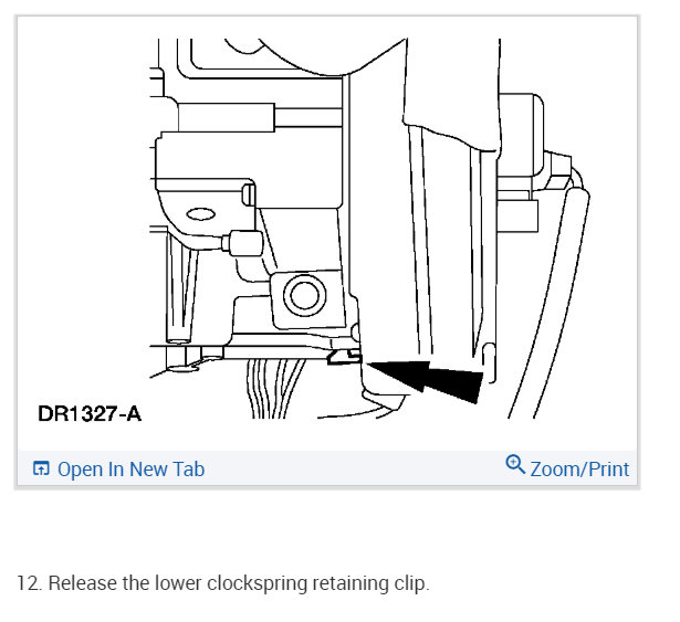

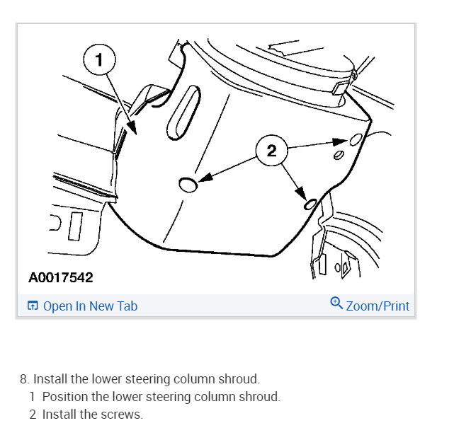

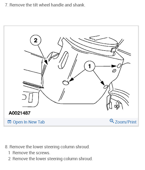

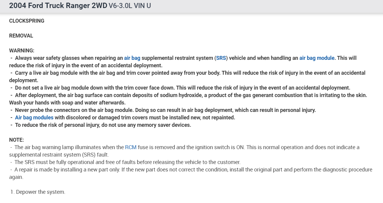

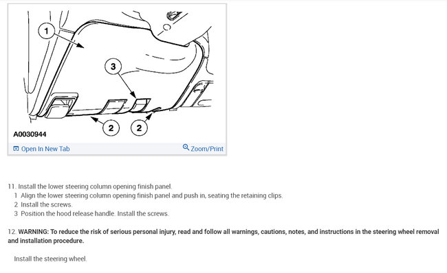

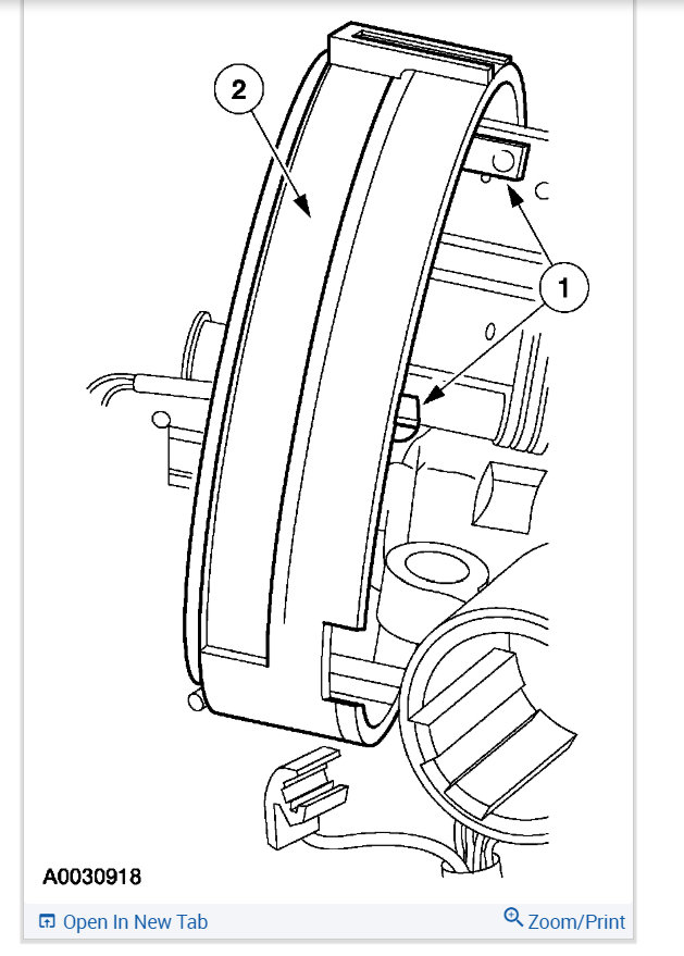

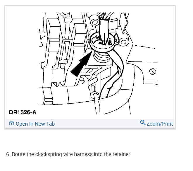

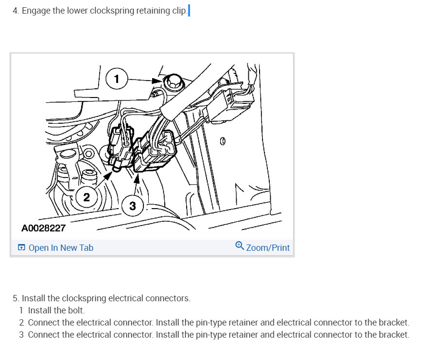

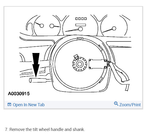

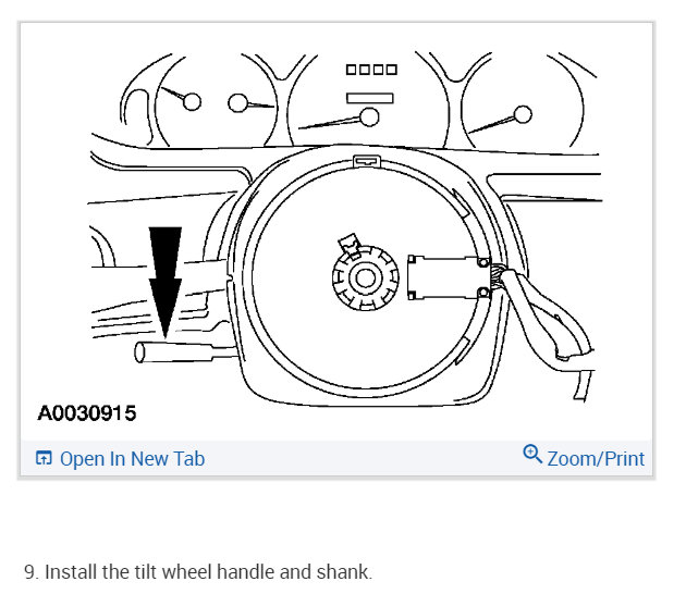

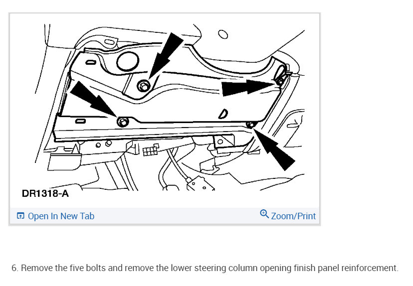

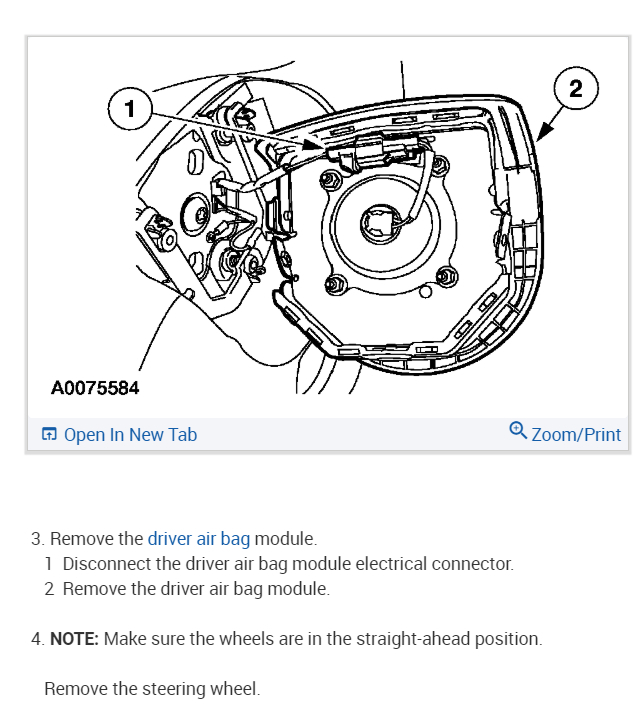

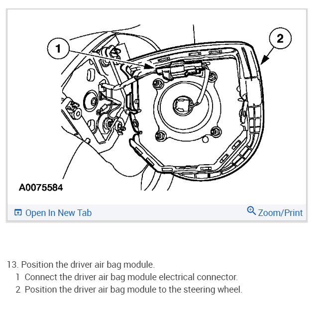

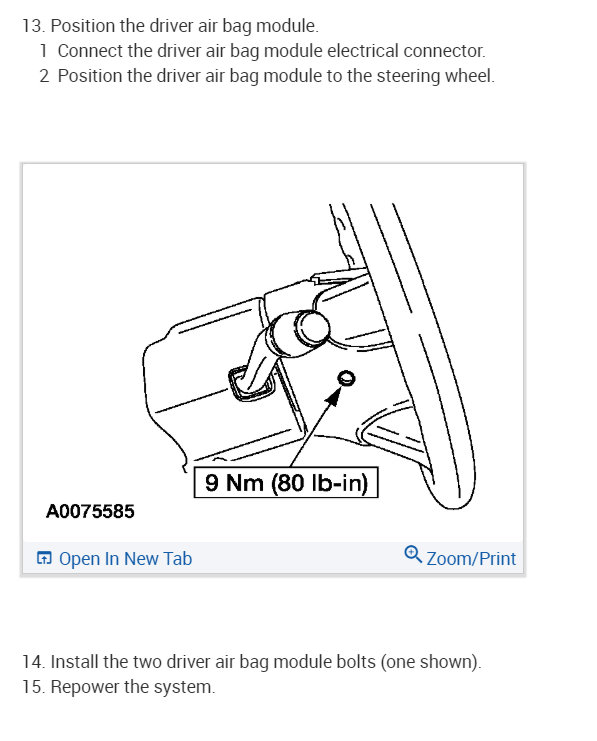

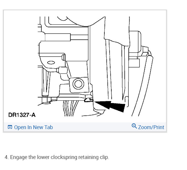

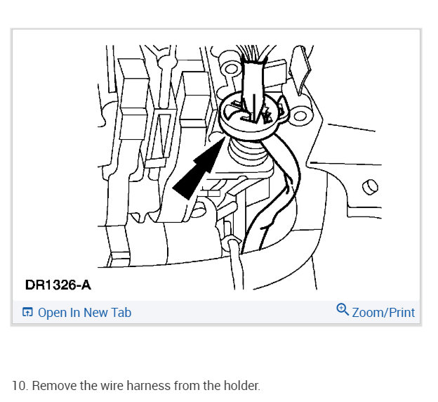

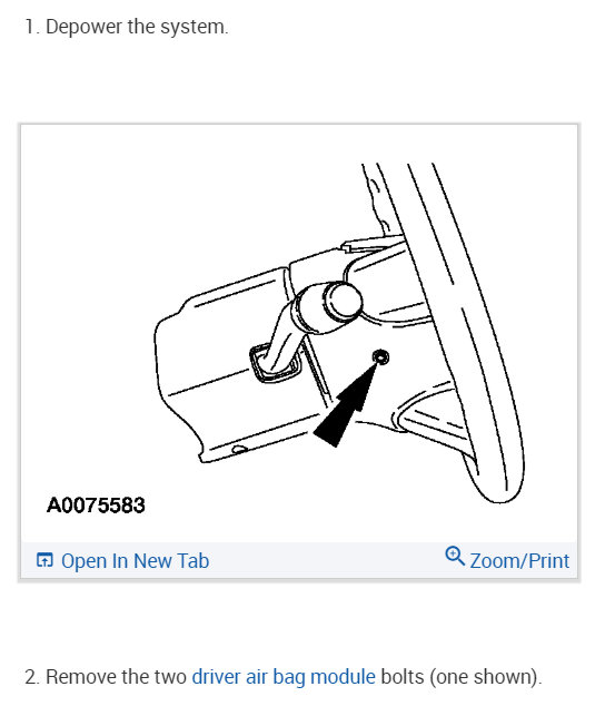

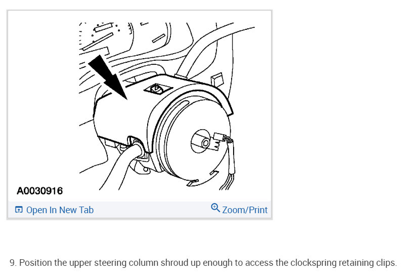

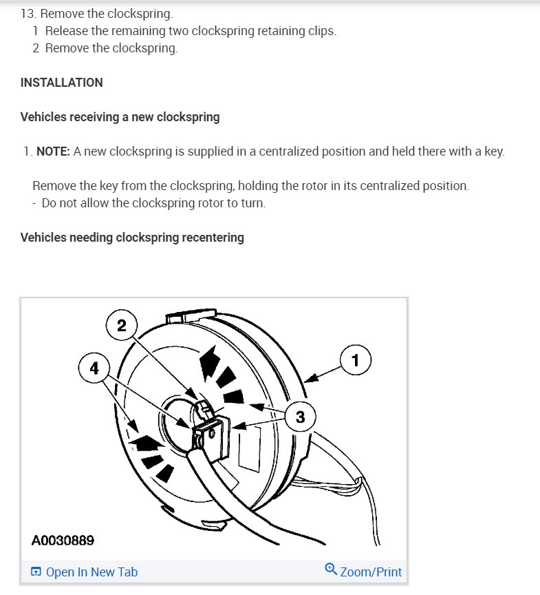

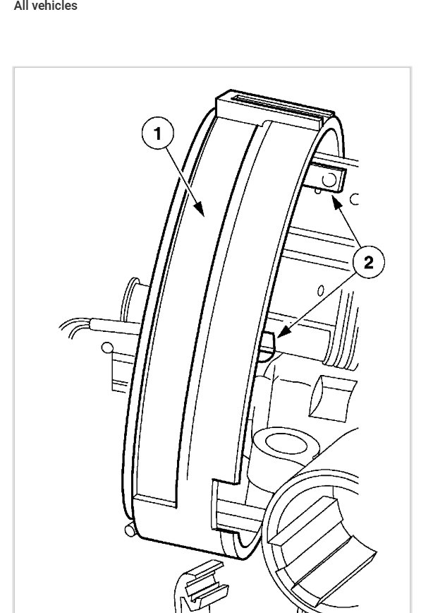

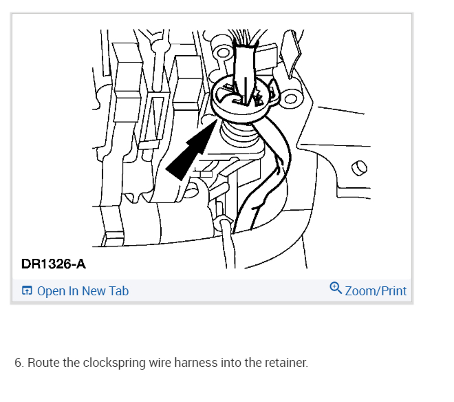

HI there,

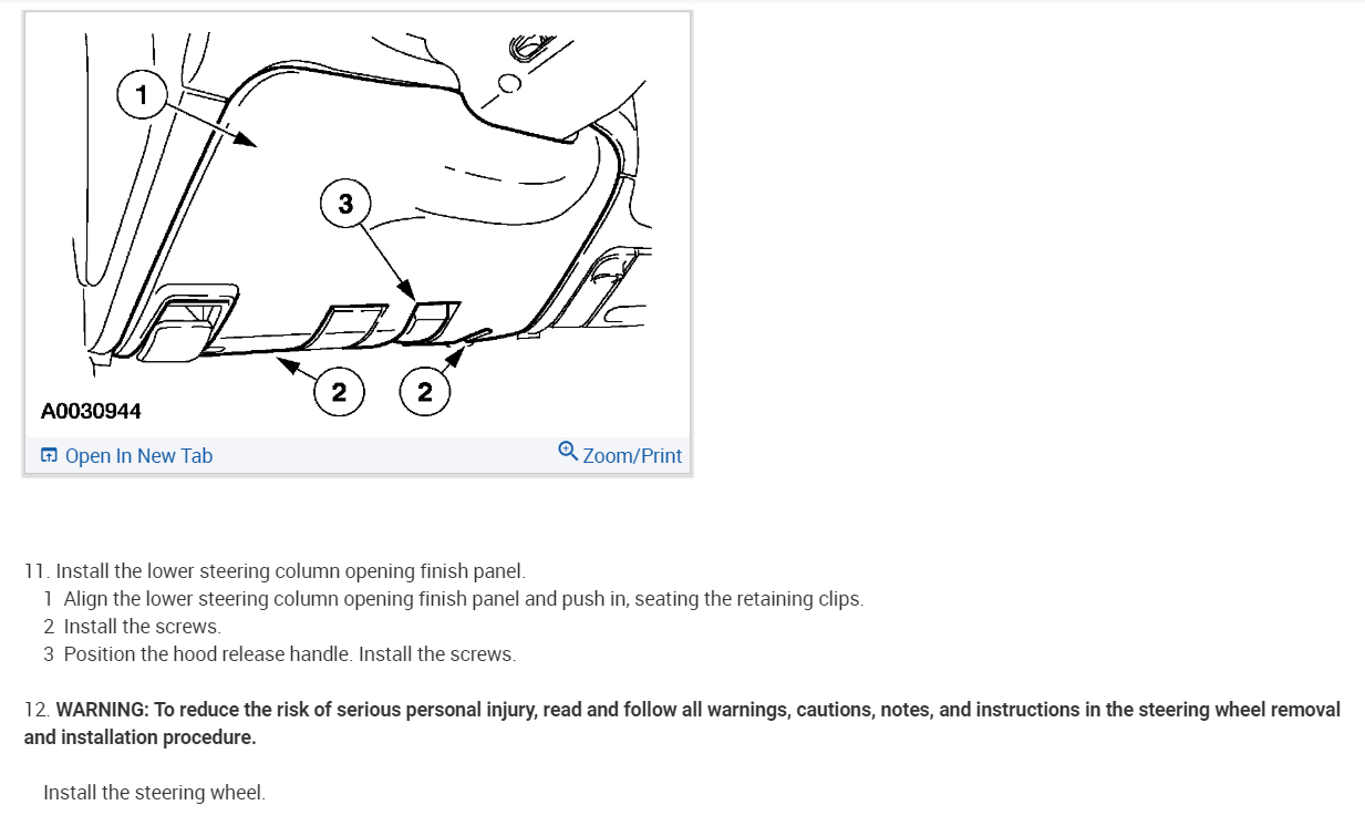

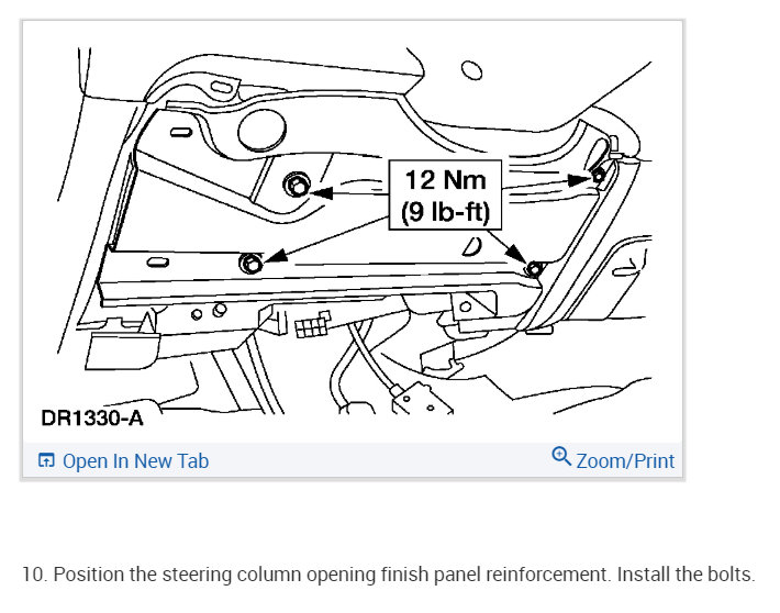

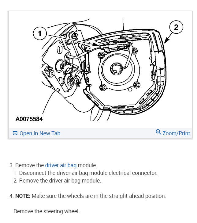

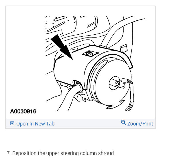

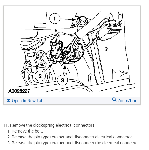

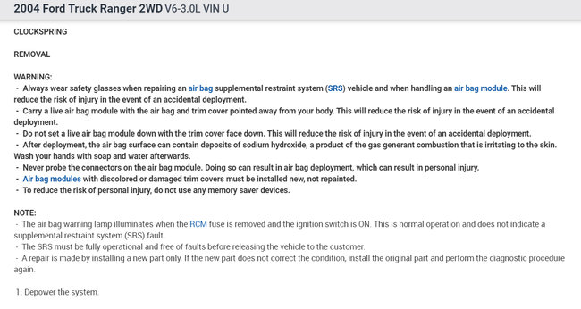

9 times out of 10 it will be the clock spring behind the steering wheel here is how you can change it out. To be sure this video will show how to get the codes.
https://youtu.be/gnSGfEqrf_w
