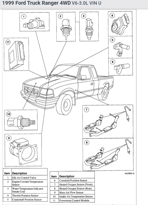

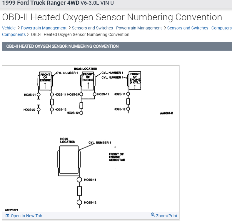

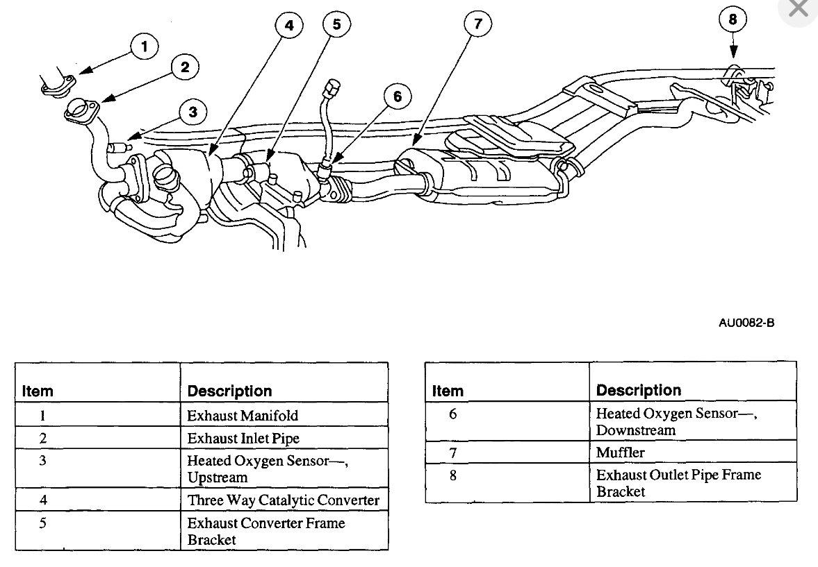

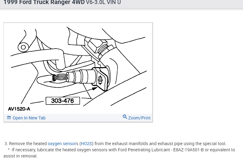

Where is the Bank 1 Sensor 2 O2 sensor located? 3.0L XLT.

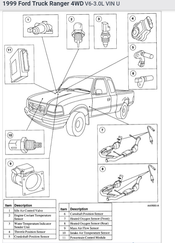

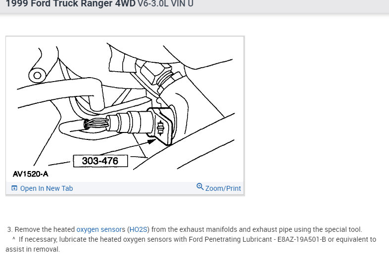

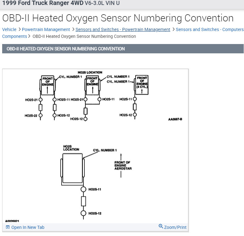

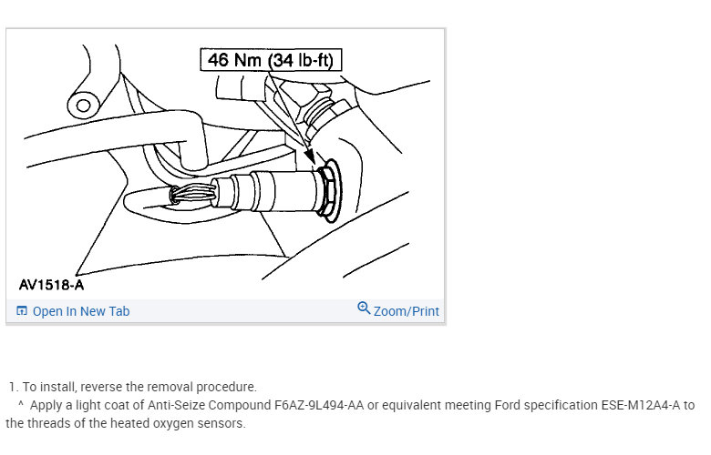

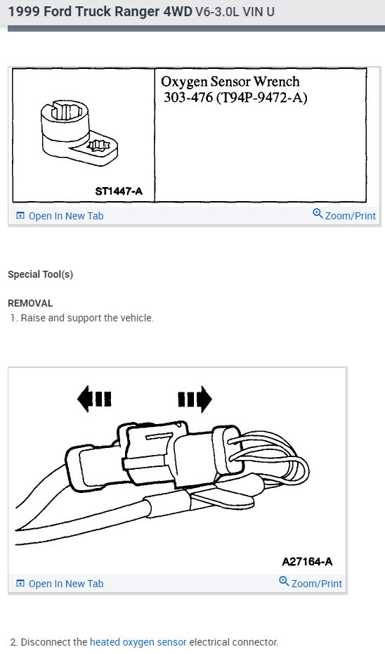

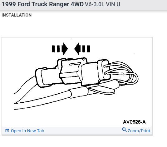

Tuesday, July 27th, 2010 AT 1:56 PM
SQM
MECHANIC
6,383 POSTS
The bank 1 sensor 2, oxygen sensor is located on the exhaust pipe after the catalytic converter on the passenger side of the vehicle.
