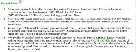

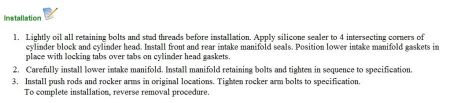

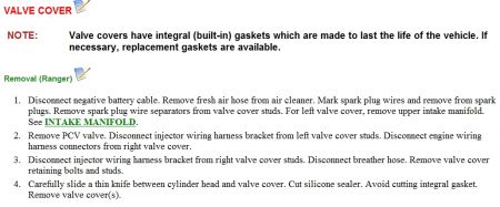

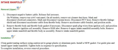

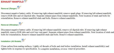

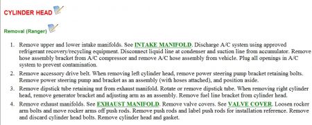

What is the proper and precise procedure to remove and replace the cylinder head(s)? This truck has A/C, power steering and usual Ford components.

BLUELIGHTNIN6
MECHANIC
16,542 POSTS
Tuesday, October 12th, 2010 AT 12:19 AM
