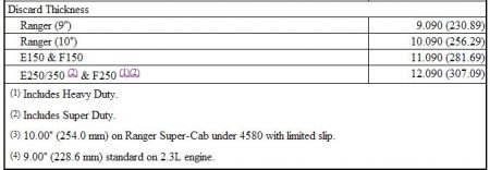

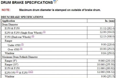

How do I determine the correct dia. Shoe to use
Tuesday, September 1st, 2009 AT 9:42 PM
BLUELIGHTNIN6
MECHANIC
16,542 POSTS
Hello
Here are your vehicle's drum brake specifications.
